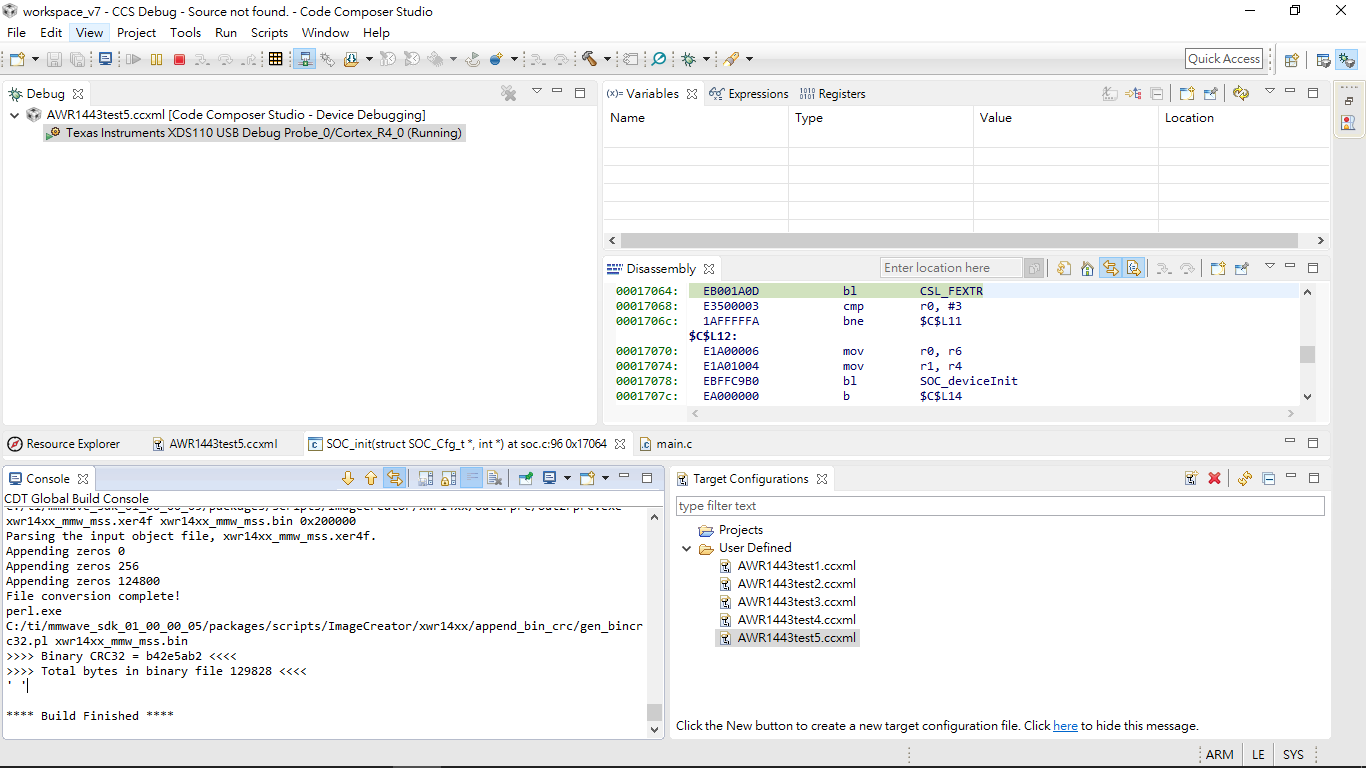

Hi
       I am try to demo the AWR1443, I follow the guide to 5.3 "Running the binary". But the console window do not show anything. Does it running take long time? If not What can I do to check it is working or not? Thank you.

    Can you provide a link to the guide you are following? Also please a provide a screenshot of your CCS so I can see what the issue is.
    ki
  • Hi Ki
     The guide what I refer is in the attachment. and the Screenshot of my CCS as below. Thank you 5618.mmw_user_guide.pdf

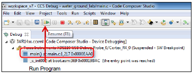

  • Were you able to get to main ok before pressing the Run/Resume button?

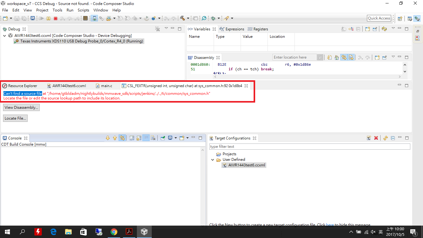

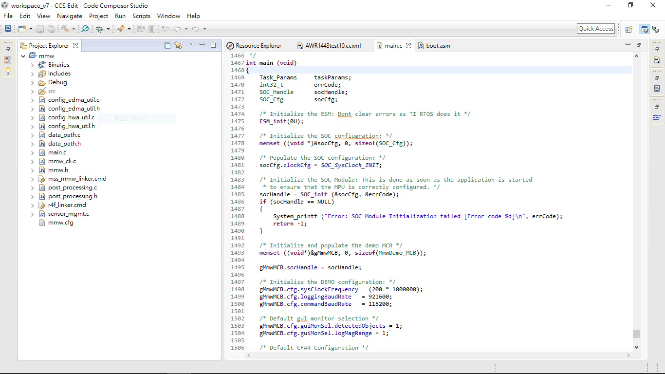

    The "main" you mean is like below screenshot ? The screen shot is what I rebuild the project  and the console window say it succeed. But after I click the run button the console window do not show anything. Thank you.
  • Hi Ki
    I try to run it again and pause it randomly that  found the error like below
    "Can't find a source file at "/home/gtbldadm/nightlybuilds/mmwave_sdk/scripts/jenkins/../../ti/common/sys_common.h" "
    or
    Can't find a source file at "/home/gtbldadm/nightlybuilds/mmwave_sdk/ti/drivers/soc/src/soc.c"
    Is that mean I have wrong path? Thank you .
  • I meant reaching main when starting a debug session like in the screenshot on slide 23:
    or
    Please see:
    http://software-dl.ti.com/ccs/esd/documents/users_guide/sdto_ccs_debug-handbook.html#debugging-library-code
    thanks
    ki
  • Yes, I reach main to start debugging session. But It's not working on the console window.

  • Thank you. When I try to run your code, I can see that it gets stuck at line 1486 of main.c. I'm not sure why it gets stuck but this appears to be the issue. I know that there is a dependency on silicon revision ES2.0. I'm not sure what I have.
    In any case, I am not familiar enough with the HW and SW to provide much more suggestions. I am going move this thread to the mmWave forum. The experts there can provide more suggestions

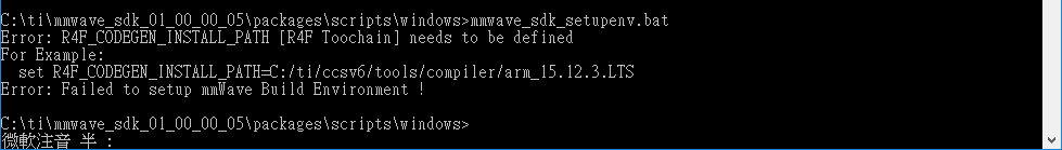

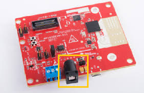

    1.In the guide says "Power off" Does it mean there is a switch to off it ? Or I just pull the plug to off it? like picture as below.
    2. After I do the step 3. 3. 1. Demonstration Mode to load image on EVM and power off, then remove the jumper on SOP2, and power up again. The DS1 (NERR_OUT) LED turns on. Is it correct?Because refer the guide " AWR1443, AWR1243 Evaluation Module (AWR1443BOOST, AWR1243BOOST) mmWave Sensing Solution User's Guide " Page17 Table 6 say it means the hardware error.But I just follow the guide to remove the jumper.
    3. Where can I get the "setenv_tools.bat" file?

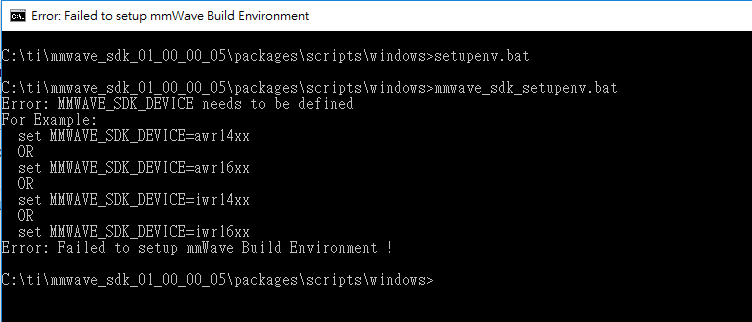

    4. After I do the step 4. 4. 2. 1. Windows I run the "mmwave_sdk_setupenv.bat". It shows error as below . How can I define the R4F?
    Thank you very much.

    You will need to create the setenv_tools.bat by copying from user guide . Attached

    for your reference. You can change the path of the tools and use it in your environment.
    Also please use the tools version  as mentioned in the user guide.
    Raghu
  • Hi Raghu
        Thank you for your help. but it still have error as below. and The DS1-LED turns on after I remove the jumper on SOP2, is it correct action? I am new for CCS and AWR1443 sorry to ask basic problem and thanks for your responding.
  • Hi Raghu
    I have solved the mmWave Build Environment problem. But the previous question do not solve it. Below is  my problem.

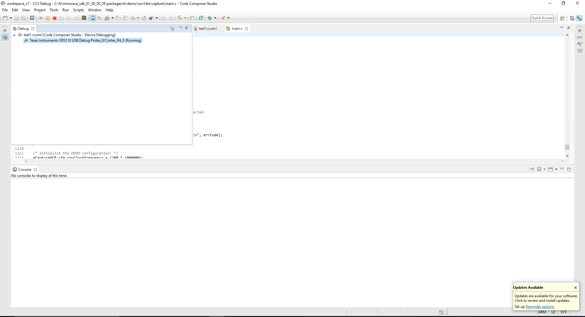

  • Hi Raghu
                    Here is my snapshot. I choose the " mmWave SDK demo-14XX->CCS project " in Resource Explore. Thank you.
  • Wendy,
    If you have followed the steps mentioned in the "3. 3. Loading images onto xWR14xx/xWR16xx EVM" + "3. 3. 2. CCS development mode", I do not see any reason why you are not able to get the mmwave demo working on the AWR1443BOOST.
    You will need to download the code on "Cortex_R4_0" .This is the core to download your mmwave demo image.
    I am not able to understand why you are facing trouble in running device in debug mode if you have followed above step.

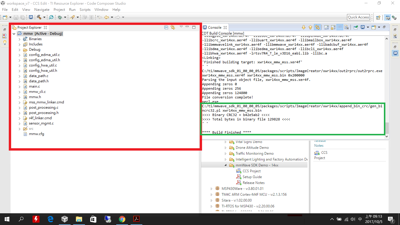

  • Hi Raghu
         Is it possible that I rebuild the wrong .xer4f file ? So the console window shows nothing when I run the binary to the EVM. Because I found the number of "Total bytes in binary file" is different from guide. The guide is 130260 and mine is 129828. It also show 2 errors at the front. Below is the result of rebuild project.  I am the new in CCS and mmWave  and I very desire to figure it out. Thank you.

  • Wendy,
    The compiler version recommended is "16.9.1.LTS" but you seem to be working on a different compiler version. Can you compile on a recommend versions of the tools as mentioned earlier.
    -Raghu

  • Your build procedure is showing the compiler used is ""C:/ti/ccsv7/tools/compiler/ti-cgt-arm_16.9.4.LTS/bin/armcl"" , you can check if you have the 16.9.9LTS in ""C:/ti/ccsv7/tools/compiler/" fodler.
  • Hi Raghu
    It is ti-cgt-arm_16.9.4.LTS. Thank you.
  • Wendy,
    Looks like you are trying the console in CCS.
    You will need to connect to the teraterm/hyperterminal and connect to "XDS110 Class Application /User UART" . Then hit "Enter "in the after connecting to this terminal.
    -Raghu
  • Hi Raghu
    I flashed the .bin file by Uniflash and choose the connect to "XDS110 Class Application /User UART" on Teraterm but it show nothing after I hit "Enter". Thank you.
  • Wendy ,
    Can you follow the procedure as attached ?
    capture_demo.pdf
    -Raghu
  • Hi Raghu
       I follow the guide which you gave me, but it has the same problem as demo. The console window shows nothing as below. so I faile to execute binaray.
    And I try to flash xwr12xx_xwr14xx_radarss.bin and xwr14xx_mmw_demo_mss.bin by Uniflash. Then run it still fail. Dose mmwave_sdk_01_00_00_05 this package support the chip ES.1?
    How can I check my chip is ES.1 or ES.2 on the computer?
    Thank you.
  • Hi Raghu
            I try the older version of SDK which is 00_08_00_00, and then the EVM is work. So I think the latest AWR1443 SDK do not support my chip.
    Thanks for your helping and patiently response to me.
  • Wendy,
    The line4 of the device marking should read 964D for ES2.0 and just 964 for ES1.0.
    -Raghu
