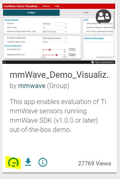

  • Hi Gunter,
    The data format for 14xx is same with the 16xx. You can refer this document: file:///C:/ti/mmwave_sdk_01_01_00_02/packages/ti/demo/xwr14xx/mmw/docs/doxygen/html/index.html
    Also, you can refer the mmWave Visulizer's code to decode to data.
    Link:
    https://dev.ti.com/gallery/
    Then, import to GUI Composer, and you can see how this GUI decode the data.
    Wesley
  • Hi Wesley,
    thanks, I see the js code for the Visualizer in the GuiComposer. But I can't find exactly the place where the Byte stream from the UART is being read. Can you point me to the right section?
    Are you aware of a simple Python script? I have heard mention of it in the BU.
    Thanks!
    --Gunter
