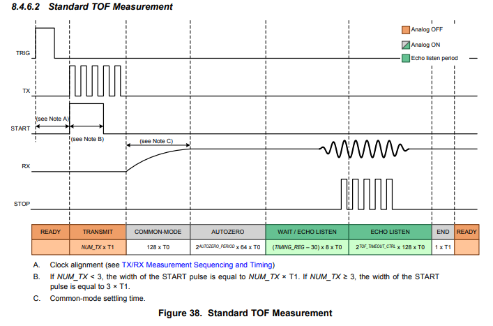

I am designing a low-volume flow sensor for water with the TDC1000-7200EVM and 1MHz transducers (STEMINC SMDM21F1000, https://www.steminc.com/PZT/en/ultrasonic-flow-sensor-1mhz-send-receive). I cannot, no matter the settings, achieve a Delta ToF close to zero. I can see clear START, STOP, and COMP_IN signals on an oscilloscope, but the values output in the GRAPH tab of the GUI are always high (~300 ns) with a significant STDEV. I’m testing with deionized water at zero flow. Additionally, the ToF I measure on the scope varies with the AUTOZERO_PERIOD set in the GUI; shouldn’t that be a function of distance rather than a register setting? Any help regarding these matters would be much appreciated.

    To address the final question first, if the autozero setting is affecting the TOF, then this means that you are masking the received signal. The receive circuitry is not fully active until the autozero period is complete, so if the autozero setting is long enough, it will prevent the device from seeing the echo signal until it is complete. Please refer to this measurement sequence diagram:
    If the autozero is masking your return signals in this way then it will also affect the delta TOF.

    I’ll look into adding an interface circuit to my test apparatus. Regarding the absolute ToF, I may have been unclear in my description. Based on the distance between transducers, I expect a ToF of 73 μs. At the lowest possible autozero period (8 μs), I measure 32 μs from one transducer’s excitation to the other’s reception of signal and generation of STOP pulses. My ToF is consistently 24 μs greater than my given AUTOZERO_PERIOD. I doubt very highly that false STOP pulses are being generated, as the receiving transducer’s resonance is concurrent with STOP pulse generation.

    I noticed that the LNA_FB setting is set to resistive. If you are using an unmodified TDC1000-TDC7200 board you should set the mode to capacitive as this will set the proper gain and highpass for the LNA with the external capacitors on the EVM (C42 and C43).
    Also for such a close spacing in a liquid medium, the number of pulses generally does not need to be quite so high. This will depend on the mounting solution, but 2-3 TX pulses should be sufficient over a short distance in liquids.
  • Scott,
    I changed LNA_FB to capacitive and lowered the number of pulses. Thank you for your help.
