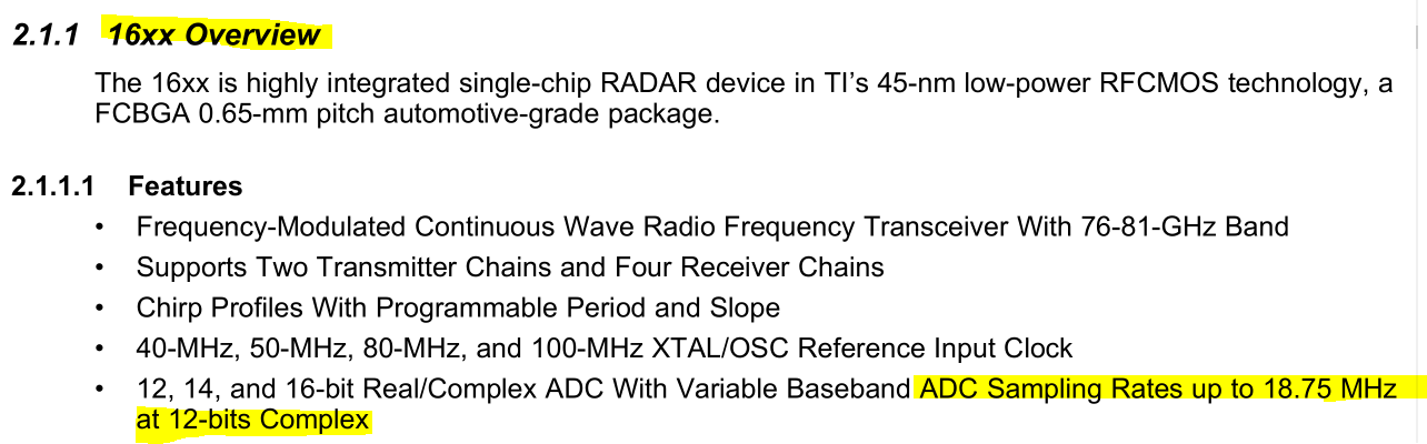

What is the maximum ADC sampling rate?
In AWR1642 Single-Chip 77- and 79-GHz FMCW Radar Sensor file:
In AWR16xx/14xx Technical Reference Manual file:
So they are contradictory!
At last,I want to know how much is the adc's maximum sampling rate and how much is the step of adc sampling rate ?
For the maximum ADC sampling rate of 1642 device please refer to the datasheet. Datasheet has the correct number.
We need to update the Technical Reference Manual to reflect this change. For timing being please refer to Datasheet which reflects the correct values of sample rates.
