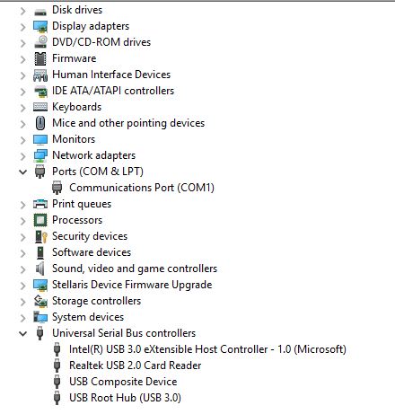

As you can see, it's still in DFU mode even after programming and resetting. I also tried changing the serial number using -n command but nothing happens. I believe my PC still recognizes the device as a USB because -e command says 1 device found. What else did I miss? Note that the same routine worked when I tried to upgrade the IWR1642BOOST that we bought from TI.
I cannot proceed to programming the people counting bin using Uniflash tool because the device doesn't enumerate as XDS110 Application UART and Data Port.
Also, when I went to the device manager, the device is nowhere to be found.
Hi Mary,
you need to flash the bootloader as well. For a new and empty TM4C:
xdsdfu.exe -e
xdsdfu.exe -b bootloader.bin
xdsdfu.exe -f firmware.bin -r
xdsdfu.exe -e
That should do the trick.
