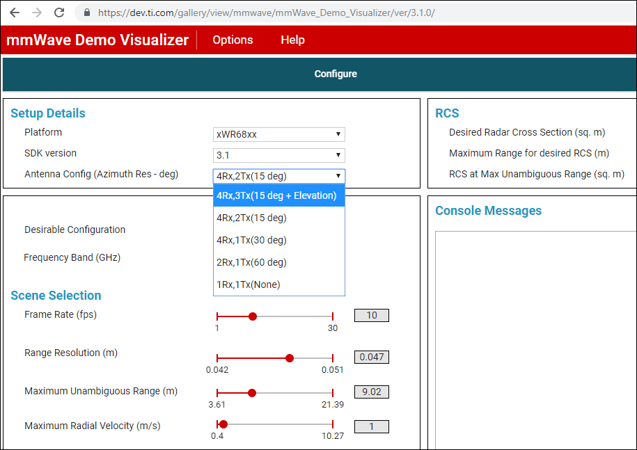

hi,I just do it like your said,but I did not know how to get 3D cloud data in the mmWaveDemoVisualizer, and I want to know what's the detection range of IWR6834? thanks for your answer!
To get 3D point cloud in mmWaveDemoVisualizer, you need to select the 4RX, 3TX Antenna Configuration as shown in the picture below. The maximum detection range depends upon factors such as type/shape of object (RCS), chirp configuration, antenna gains etc. Please refer to the following resources to understand the maximum detection range:
