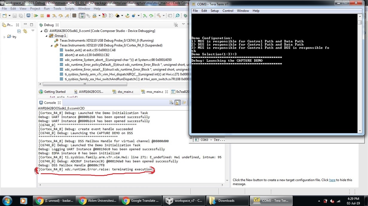

At the moment, my issue is that I am trying to get ADC data from AWR1642BOOST EVM Rev B. I am using CCS 7.4 and mmwave sdk 1.00.00.05.
I am facing exactly the same problem as mentioned in the following TI E2E thread:
https://e2e.ti.com/support/sensors/f/1023/t/738304?CCS-AWR1642-Raw-ADC-data-Capture-Demo
 I have been following the same steps, except the following differences:
1. After step 1, I am using CCS to upload files to dss and mss as mentioned in para 2 of section 3.3.2 of mmwav sdk user guide rev 1.0.0. (file attached).
http://e2e.ti.com/cfs-file/__key/communityserver-discussions-components-files/1023/mmwave_5F00_sdk_5F00_user_5F00_guide-1.0.0.pdf
After that I run the C674 and R4F cores
2. I am using teraterm for COM port communication. I select the correct COM port and set the correct baud rate i.e. 115200.
The selection appears at the Tera term window. However, as soon as I select option 1 or option 3, nothing more appears on the screen even if I hit enter again.

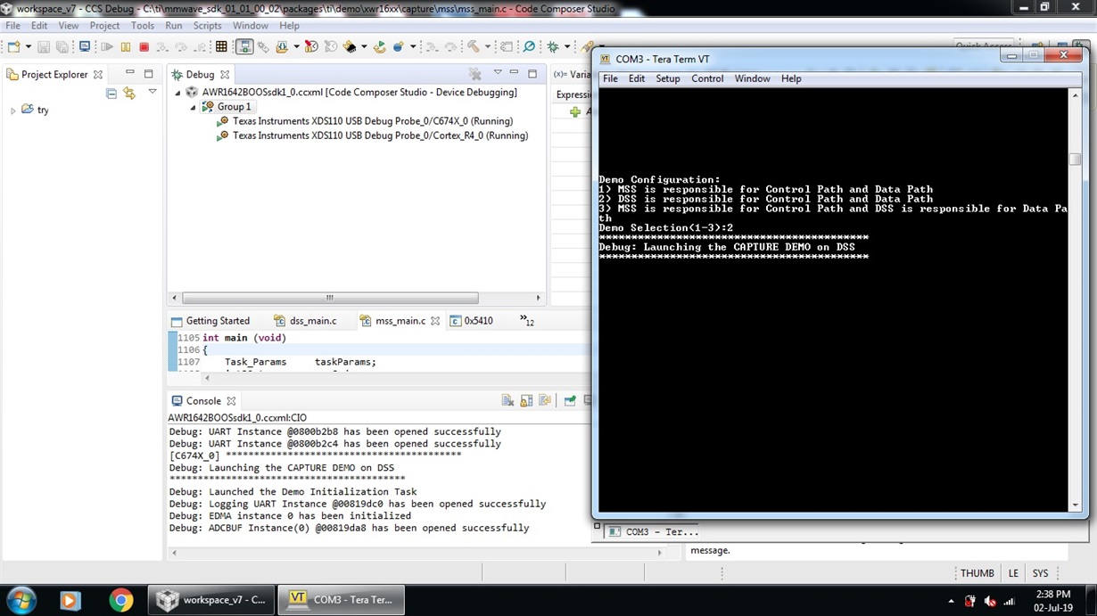

  • For question 2: "If i need to input that text into Teraterm window then it is not working, there is just a pointer there."
    From my understanding when they say " Once you get to step 3 in your process, you need to copy the contents of this file into your CLI program: C:\ti\mmwave_sdk_01_01_00_02\packages\ti\demo\xwr16xx\capture\capture_demo_script.txt " as you noted, they literally mean to copy an paste each line of code provided into the terminal as you should be able to input commands.
    That being said, I am having the same problem you are where the terminal completely freezes after selecting any option (1, 2, or 3).  According to the user guide documentation provided with the 1.1.0.2 SDK (which is what I am trying to use to do the same thing) section 3.3.3 #3 says:
    " For mode 2(DSS only mode), there is no configuration CLI. All configuration parameters are hard-coded in the code and are same as seen in the capture_demo_script.txt."
    This leads me to think that running option 2 would not require configuration, however, after attempting to run this several times, following the steps provided in the documentation does not yield any information after connecting to the device using CCS.  I'm not sure if you have tried option 2 to test this theory or not as I see in your screenshot that you tried option 3.
    Long story short, try reflashing and connecting via the command line, then connect via CCS and check the values stated in section 3.3.3 5) c. of the Expressions Window.  Let me know how this goes, or if you find any more information out, but I am getting an error from CCS (probably because the command line is frozen):

    6) My latest attempt was with option 3 again with SDK 1.1.0.2; earlier numerous attempts with SDK 1.0.0.5 (with and without re-built binaries) produced same result.
    With SDK 1.1.0.2, when I selected option 3 on Teraterm, I got the following (error) messages on CCS console.
    I think the main cause is XDC. I was suspecting this so I tried, both the latest version of XDC and the version mentioned in SDK release notes while I re-built the binaries for C674 and R4F, but still no success in both cases. The same XDC error appears every time.
    May be you can comment or add some thing ?

    4) Although I did not think that I need not to use xwr16xx_capture_demo.bin but still I attempted the following today:
    I used SDK 1.0.0.5 and I used re-built binaries and I tried following combinations:
    i) Meta Image xwr16xx_ccsdebug.bin at location C:\ti\mmwave_sdk_01_00_00_05\packages\ti\utils\ccsdebug (using Uniflash) and then I uploaded the xwr16xx_capture_demo_dss.xe674 and xwr16xx_capture_demo_mss.xer4f to their respective processors.
    ii) Meta Image xwr16xx_capture_demo.bin at location C:\ti\mmwave_sdk_01_00_00_05\packages\ti\demo\xwr16xx\capture (this .bin was re-built) (using Uniflash) and then I uploaded the xwr16xx_capture_demo_dss.xe674 and xwr16xx_capture_demo_mss.xer4f to their respective processors.
    iii) First Meta Image xwr16xx_ccsdebug.bin at location C:\ti\mmwave_sdk_01_00_00_05\packages\ti\utils\ccsdebug and then Meta Image xwr16xx_capture_demo.bin at location C:\ti\mmwave_sdk_01_00_00_05\packages\ti\demo\xwr16xx\capture (this .bin was re-built) (using Uniflash) and then then I uploaded the xwr16xx_capture_demo_dss.xe674 and xwr16xx_capture_demo_mss.xer4f to their respective processors.
    iv) First Meta Image xwr16xx_capture_demo.bin at location C:\ti\mmwave_sdk_01_00_00_05\packages\ti\demo\xwr16xx\capture (this .bin was re-built)  and then Meta Image xwr16xx_ccsdebug.bin at location C:\ti\mmwave_sdk_01_00_00_05\packages\ti\utils\ccsdebug (using Uniflash) and then I uploaded the xwr16xx_capture_demo_dss.xe674 and xwr16xx_capture_demo_mss.xer4f to their respective processors.
    I thought that I needed to only try the step 1 but still in a desperate attempt, I did all 4 combinations but none worked.
    Every time, there was same failure that the teraterm window froze with the following error in CCS console:
    ti.sysbios.family.arm.v7r.vim.Hwi: line 271: E_undefined: Hwi undefined, intnum: 95
    xdc.runtime.Error.raise: terminating execution
    5) I was going to abandon this effort and start on mem_capture demo in Test folder (as advised by Jitendra), that a silly idea came to me. I tried it and it probably seemed to be working but needs more confirmation.
    6) I read in the this thread https://e2e.ti.com/support/sensors/f/1023/t/710804?RTOS-AWR1642-One-question-about-mmw-demo-project-in-mmw-SDK-1-1-02-
    My AWR1642BOOST EVM has ES2.0 version device. I think this was the core issue and probably a device with ES2.0 would never run a Capture Demo on SDK versions older than 2.0.0.4 (as mentioned in above thread). Had I known that, my two weeks of fruitless hard work would have been saved.
    So all guys out there, check your device, for this info and aspect.
    7) Then I tired the weird idea that I mentioned above:
    I used file xwr16xx_mmw_demo.bin located at C:\ti\mmwave_sdk_02_00_00_04\packages\ti\demo\xwr16xx\mmw as Meta Image using Uniflash. Note that it is mmwave demo file binary and it is not CCS debug file (CCS debug files were used in earlier Capture Demos in earlier SDK versions but my ES2.0 device does not support those older SDK versions).
    The next thing I did was to not load binaries from the same SDK version (2.0.0.4) but using CCS, I loaded pre-built binaries  xwr16xx_capture_demo_dss.xe674 and xwr16xx_capture_demo_mss.xer4f to their respective processors from location C:\ti\mmwave_sdk_01_01_00_02\packages\ti\demo\xwr16xx\capture. Note that I had not re-built them, these were pre-built original TI binaries and SDK 1.1.0.2 is to me the last SDK version which supports Capture Demo.
    So the point is that I installed the mata image from a higher SDK 2.0.0.4 for mmwave demo (not a capture demo) and I loaded the relevant binaries for C674 and R4F from an older SDK 1.1.0.2 for Capture Demo (not the mmwave demo).
    Surprisingly, the teraterm window started working as mentioned in section 3.3.3 of SDK User Guide 1.1.0 for SDK 1.1.0.2. Just note that I needed to change the CLI command from "low power 0 0" to "low power 0 1" ; I got this hint from TI blog for some other errors but i tried here and it worked.
    However, there are following observations:
    7a)  The chirpIntCounter does not have the correct value as given in 3.3.3#5b of SDK User Guide 1.1.0 for SDK 1.1.0.2. I will do more work on it on Monday and lets hope it works.
