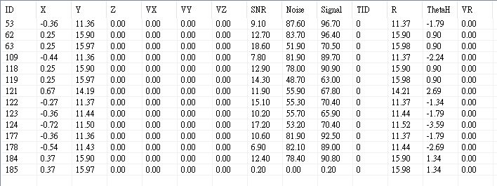

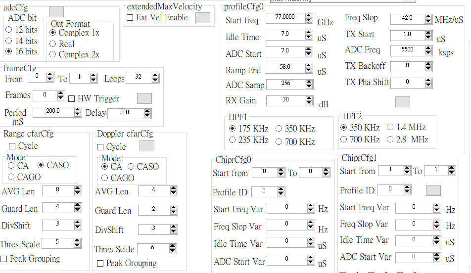

    (1) I use a 8 cm range resolution ( parts of the configure like the attached photo, and we use 256 angle bins instead of original 32 s so the angle has about 0.44 degrees quantization value) to measure a big static carton, the second attached photo show an one shot of the detected points. You can see colume R the value =11.37m has 4 detected points and their azimuth angle are -1.79,-2.24,-1.34 and -1.79. According angle resolution formula with 8 virtual antenna, the angle resolution is 2/8 ~=14.3 degree. So there are has 4 detected point in the same R and V within angle resolution. Is that correct?

    Question (1)
    This should not be correct. In the same range bin only a point should be detected.
    Are you sure these are not reflections from the same object for different frames in time?

  • Hi
       These points are in the same TLV detected objects.
