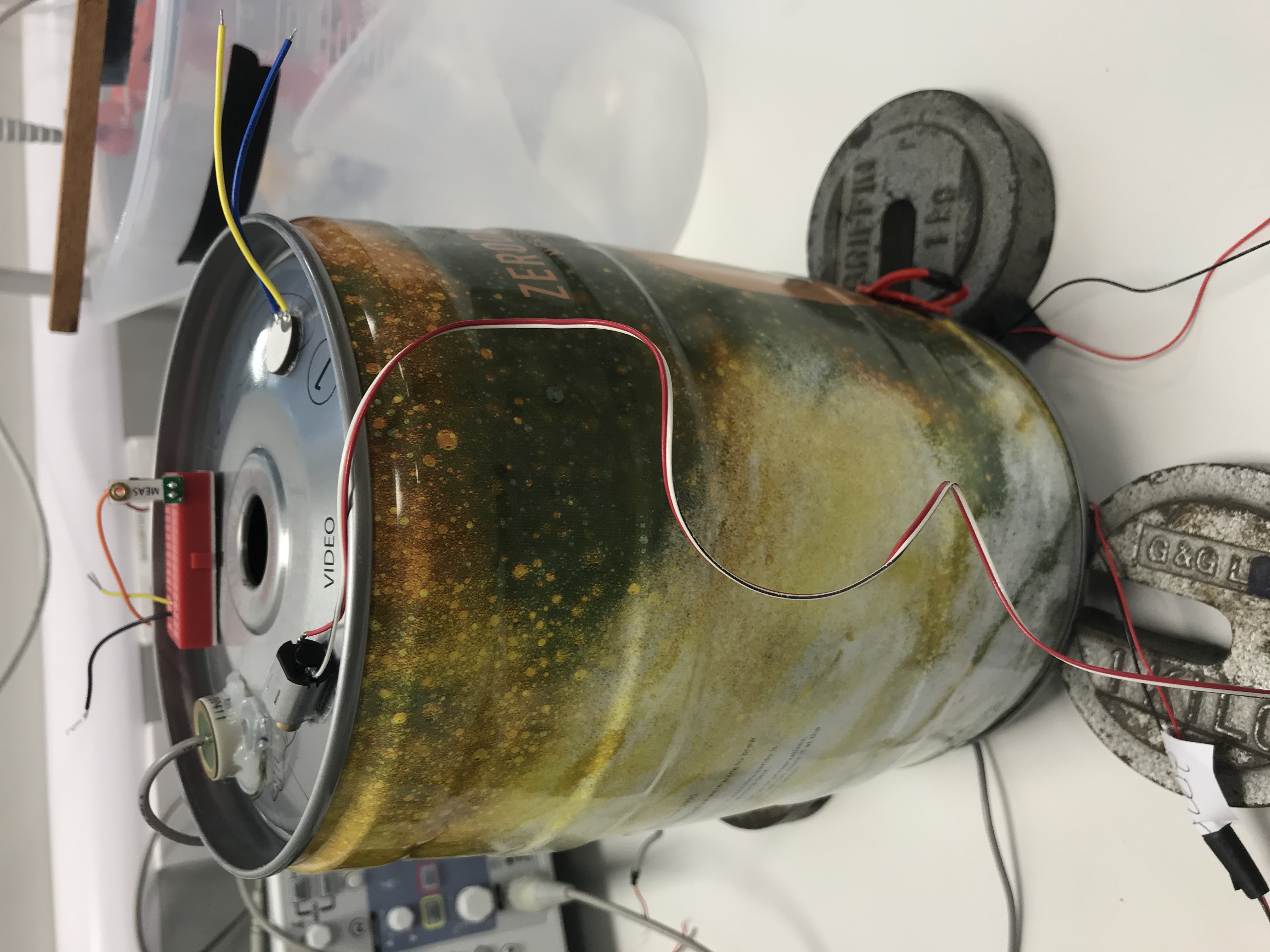

I've been trying to make sense of how the TDC1000-GASEVM and the TDC1000-C2000EVM development boards work and for that, I've been trying to get the same results for the same experiment using each one of the devices with three different ultrasonic transducers (200kHz, 300kHz, 1MHz).
The application is level sensing and this is my set (ignore the devices attached on the top of the Keg):

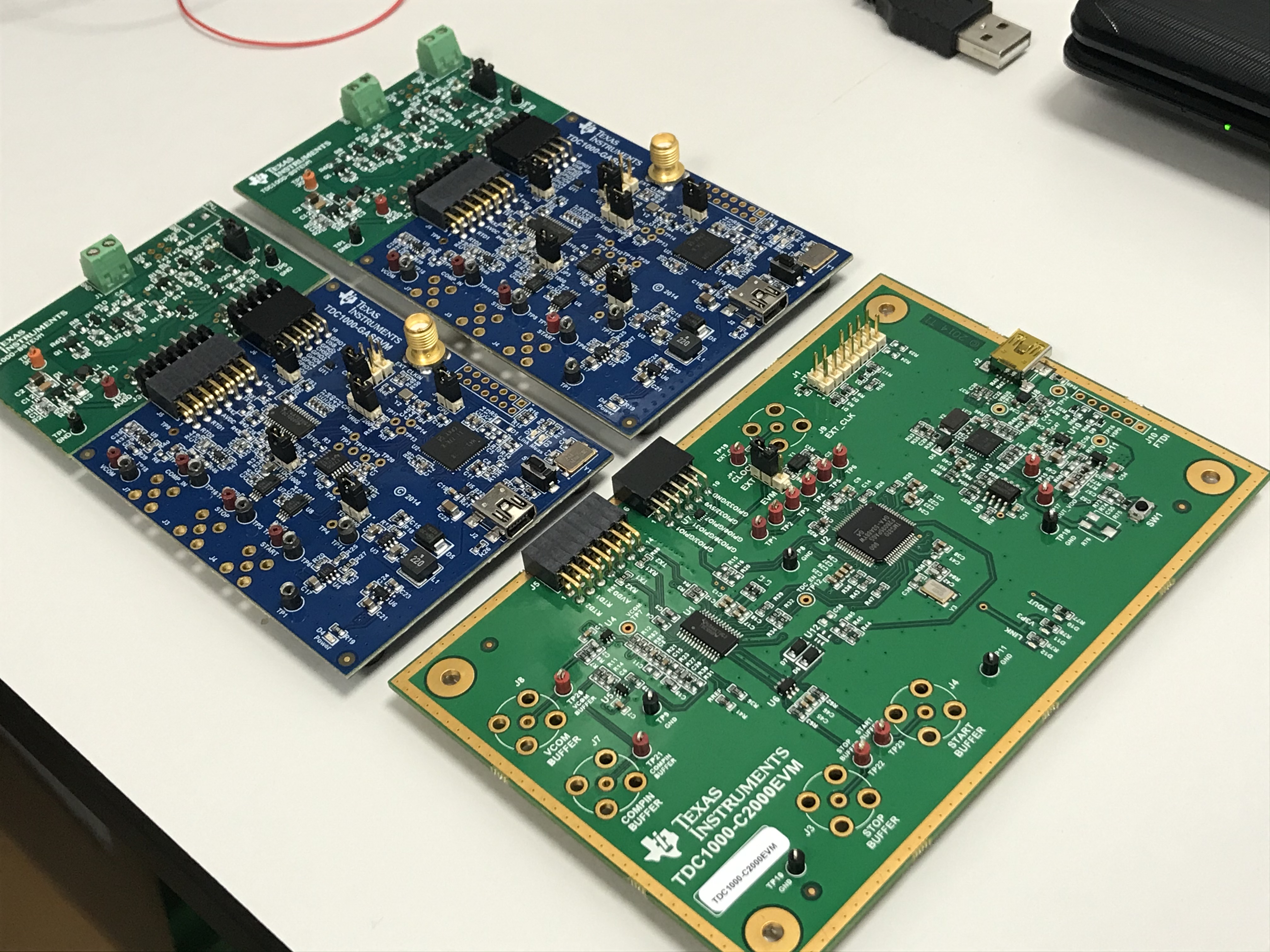

These are the boards I used:
1 - TDC1000-GASEVM
2 - TDC1000-GASEVM modified according to these instructions. The discussion started on this thread.
3 - TDC1000-C2000EVM

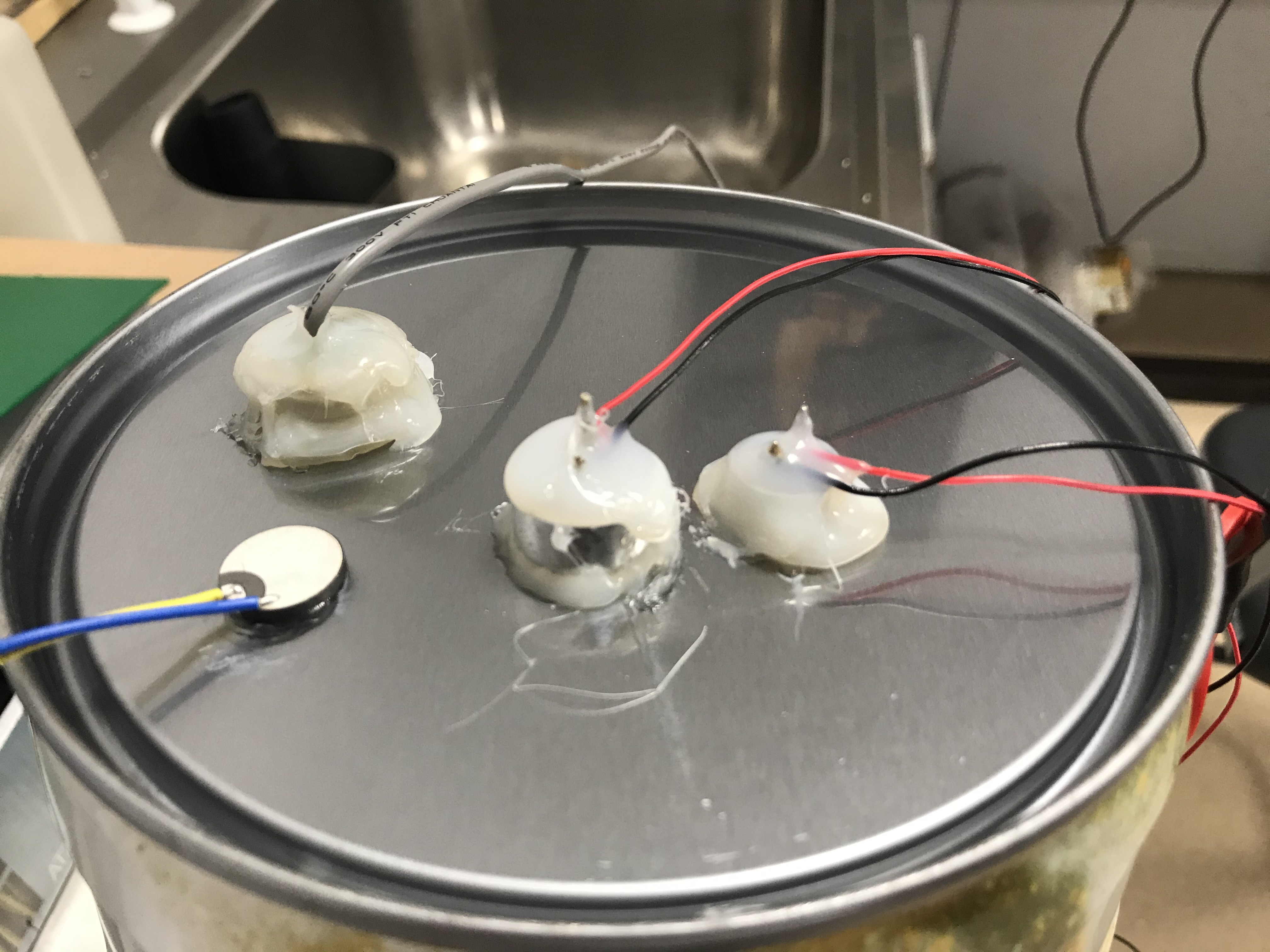

These are the transducers I used:
1 - Ultrasonic Sensor, Transceiver, 19 mm Diameter, 200 kHz: http://www.farnell.com/datasheets/1759997.pdf?_ga=2.237902720.1692459751.1569926028-1607374703.1561714650&_gac=1.116315508.1567092170.Cj0KCQjw753rBRCVARIsANe3o44DI9hNu62LNAsw5eLuCPF1nzZApoYyLi9Vhwt8IxUQ6SvMdNmueooaAsKMEALw_wcB
2 - Ultrasonic Sensor, Transceiver, 13 mm Diameter, 300 kHz: http://www.farnell.com/datasheets/1760000.pdf?_ga=2.237902720.1692459751.1569926028-1607374703.1561714650&_gac=1.116315508.1567092170.Cj0KCQjw753rBRCVARIsANe3o44DI9hNu62LNAsw5eLuCPF1nzZApoYyLi9Vhwt8IxUQ6SvMdNmueooaAsKMEALw_wcB
3 - Ultrasonic Sensor, Transceiver, 1 MHz: https://media.digikey.com/pdf/Data%20Sheets/Audiowell%20PDFs/US0014-001.pdf
Here is where the transducers are attached (bottom of the Keg). The transducers were attached according to this document.
(Please, ignore the Piezo Disc).

  • Matheus,
    I have received your question, please give us some time until next wednesday to process your info and provide with an answer/reason.
  • Any answer yet?
    On top of the issue I described in my post I'm having the same issue as presented in TDC1000-C2000EVM: Minimum level sensing.
    The thread has been locked, but no final answer was given.
  • Matheus,
    I appreciate the detail experiments that you have made in this regard to measure liquid levels through a metal keg using the different EVMs.
    Higher Ultrasonic frequency leevl of 1Mhz or more is recommended to measure the distance through liquids and lower frequency ranges of 500Khz< are typically used for measuring the ToF through air.
    Hence in your experiments you are unable to measure proper time of flight while you use the transducers other than 1MHz.
    Also the modified GASEVM is the perfect fit in terms of circuitry setup inorder to measure liquid levels through metal tanks/pipes.
    It is not possible to measure levels in metal container using the TDC1000-C2000 EVM since it can only excite the transducer upto 3.6V and we will need more energy to penetrate the metal wall in general.
