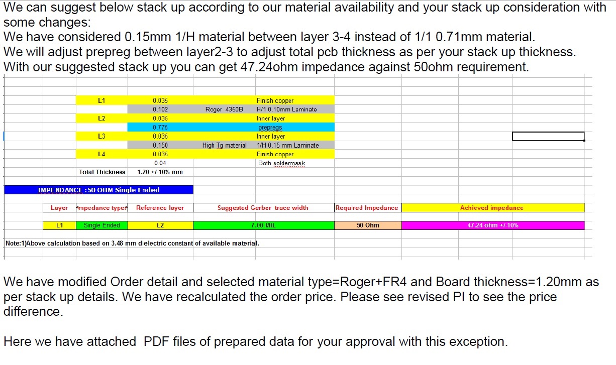

         Could you please show the stackup used in the PCB?  Also could you please share the Layout for review.

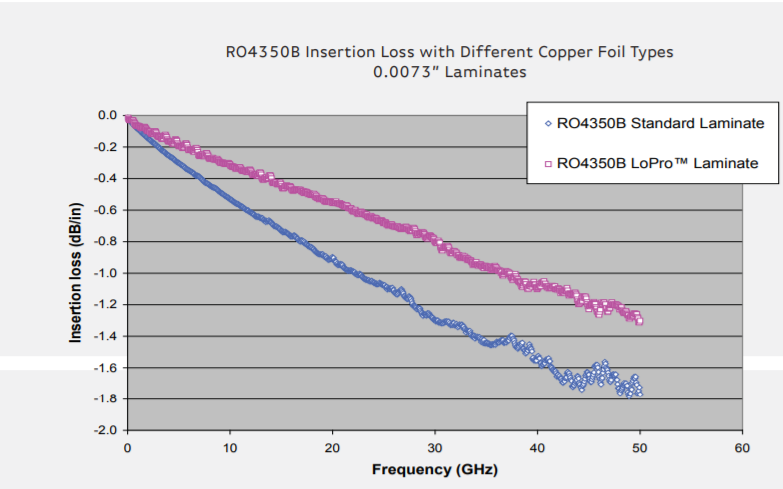

    RO4350B stack-up material is different from that of RO4835LOPRO material used in the EVM.
    Between the regular RO4350B and LOPRO version there is significant insertion loss is present in RO4350B.
    Below graph shows difference between standard laminate vs Lopro laminate.

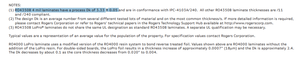

    Also I noticed that, there is a fine-print for RO4350B 4mil laminate has different Dk value as compared to RO4835LOPRO version. This may require design update to match the antenna impedance and redesign of transmission lines to meet 50 ohm target.
    It's better to use Ro4835lopro 4mil substrate as present in the EVM to overcome these challenges, Otherwise design need to be re-centered to DK value of 4350B.

  • Hi Chethan,
            Stackup

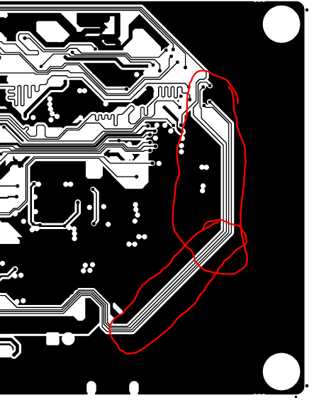

    Layout:  Layout.zip
    Provide a better solution for this issue.
  • Hello Arpit Patel,
        I see major issue in the Layout, Under the Antenna and Transmission lines there should be ground plane should be present, and no traces are allowed.
    In the below ground layer under the Antenna and connecting transmission lines, there are traces running under it.

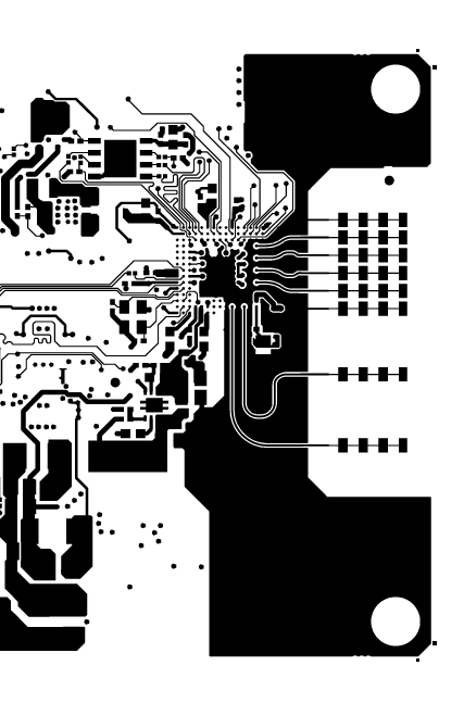

    Please refer below EVM ground plane for your reference.
    Please follow EVM layout.
