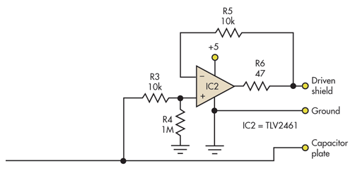

This article on driven shields is what’s confusing me. I think It’s using the approach where one of the sensor plates is grounded, which isn’t the case with the FDC2214.
https://www.electronicdesign.com/technologies/analog/article/21799482/driven-shield-enables-largearea-capacitive-sensor

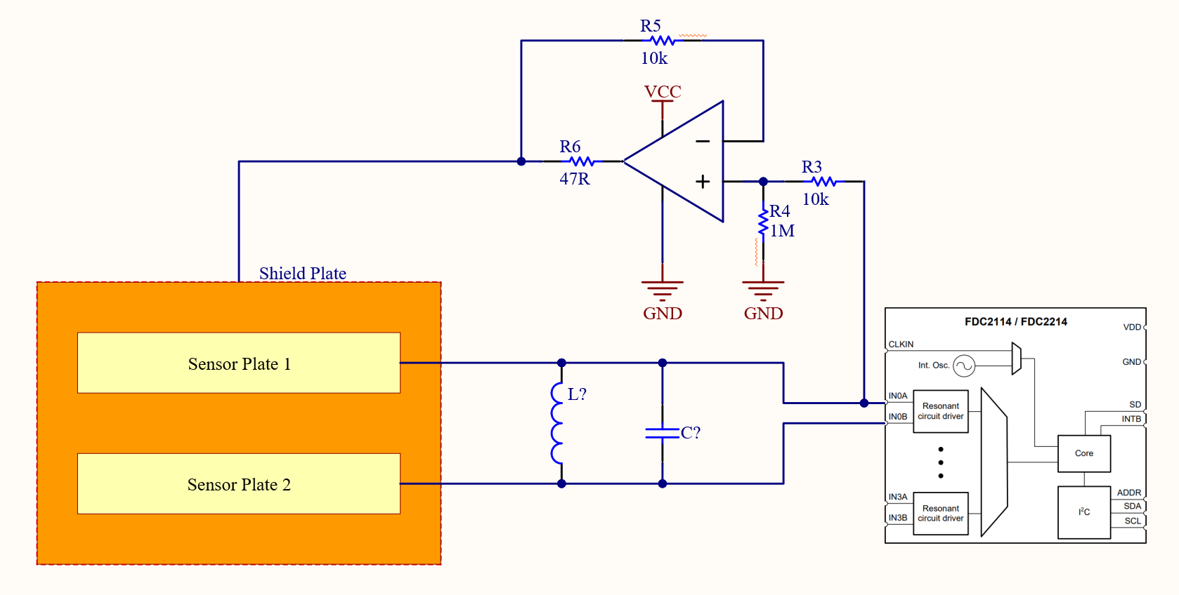

1)
This is my interpretation of the circuit mentioned in the aforementioned E2E thread.
e.g. INxA and INxB each connect to a sensor plate. One of them also connects to the positive pin on an op amp with negative feedback and with the connection point being behind the LC tank circuit.
Is this circuit what I need in order to boost the capacitive input?

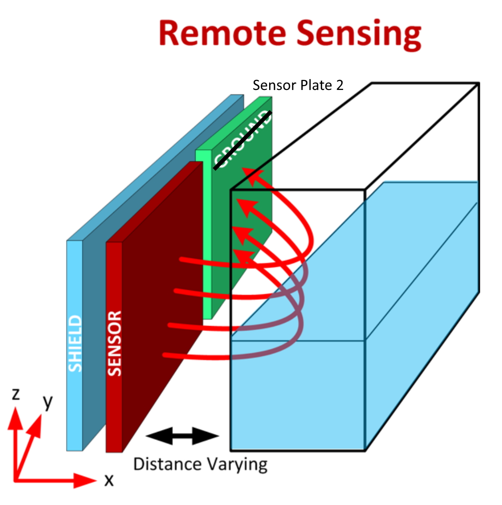

This is the approach I was going for:
(image from here: http://www.ti.com/lit/an/snoa935a/snoa935a.pdf )

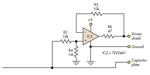

Am I correct to assume that I will still need the supporting resistors as discussed in the driven shield article?
R3 and R4 (and probably R5) prevent oscillation.
R6 helps the op amp drive the capacitive load.
Linked again:

  • Hi Dan,
    I'd be happy to help you with active shielding for the FDC2214, but can you clarify why you cannot use the FDC1004 for your application? The FDC1004 includes active shield drivers, which makes it much easier to use if you already know that your application will require active shielding.

    I’ve recently seen on another E2E thread ( e2e.ti.com/.../473144 ) that the FDC2214 is designed for single ended sensors, not differential. I clearly had the wrong idea when I named this thread “Active Shield for two plate remote sensing”. Will a singled ended design reduce sensitivity?

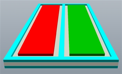

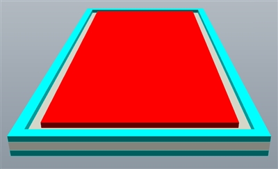

    I'm still confused about how to design the shield and the layout of the sensors. Which of the following configurations is the FDC2214 intended for?
    Legend:    SENSOR  -  GROUND  -  SHIELD - FR4
    Sensor, ground and shield:
    Sensor and shield only:
