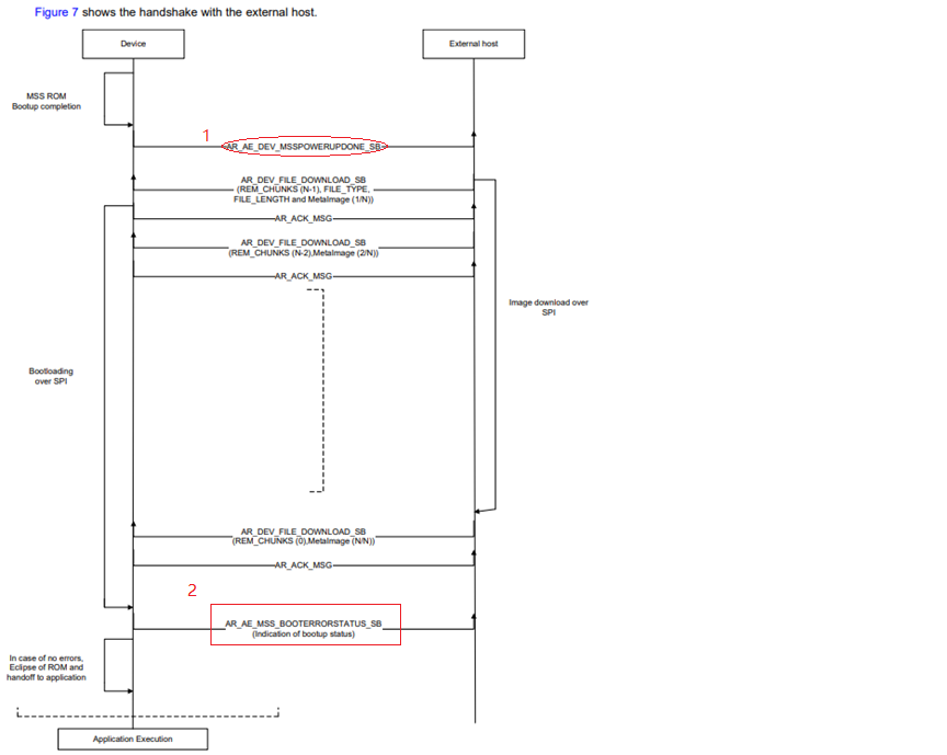

    Thank you for your prompt reply. But the third answer didn't solve my problem, I just did it according to the document(section 2.2). The whole process is correct when the example is executed on AWR1243, But there is a problem when the example is executed on XWR1642. The XWR 1642 returns a wrong data at the red box which is marked 2 in the figure,after firmware file download. After careful analysis of the data, it is found that the the data is the same as that in the red circle box which is marked 1 in the figure. In addition, AWR1243 is a es3.0 chip. Is it related to the chip version number?

    So you are saying what with AWR1642 after SPI firmware download you received the message which is of sub-block ID AE_DEV_MSSPOWERUP_SB not AE_MSS_BOOTERRORSTATUS_SB. But what is after that: does you application (which you loaded over SPI) loads up or run after this??

  • After SPI firmware download I received the message is ofsub-block ID AE_DEV_MSSPOWERUP_SB. Then  I found that my application doesn't load up. AWR1642 didn't change anything. So  I thought it didn't work. That is to say AWR1642 loaded failed over SPI.
  • I have no idea how to explain this phenomenon.  Do you have any suggestions?Looking forward to your reply!!!
    With AWR1642 (no flash connection), which firmware file you are loading over SPI? It should be AWR1642 application in metaImage format.
    I suspect you are trying to load AWR1243 firmware over SPI to AWR1642.
    You can use OOB demo metaimage binary file from mmWave SDK to load over SPI.
    And after application metaimage file loaded to device over SPI you need to connect TeraTerm/Serial port (application/UART COM PORT) to look for CLI prompt which is output from OOB demo when it boots.
    Another way to verify if application image is booted: connect MSS core from CCS and try to write on address '0x0', if you are able to write then this is application image loaded else ROM image (which is not writable).
