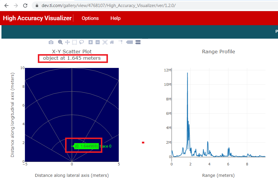

Hi
About  High Accuracy sample in IWR1642.
I am confused about calibration the offset issue. there are few link. but those didn't have detail information and doc about calibration.
https://e2e.ti.com/support/sensors/f/1023/t/699928
https://e2e.ti.com/support/sensors/f/1023/t/737693
and below link mentioned "the Fluid Level Transmitter which has this correction applied."
https://e2e.ti.com/support/sensors/f/1023/t/792177?AWR1642BOOST-High-Accururacy-Range-Measurement-lab-example
I tested the same FW and same cfg file in mmwave_industrial_toolbox_4_1_0 with Fluid Level Transmitter Visualizer 1.0 and High_Accuracy_Visualizer 1.2.0.
the result 1575 mm is accuracy with real distance.
Please share how to do calibration based on High Accuracy sample.
Is any configuration setting to improving accuracy??

  • Hi AG:
    According my testing result. there is about 8cm offset with real distance.
    You mentioned there is constant offset in visualizer(High Accuracy and Fluid Level Transmitter Visualizer). Could you point out where is it?
    I just confused. In mass production and with High Accuracy application.
    1. Should we calibration for each mmWave device??
    2.if we need to calibration for each mmWave device. how to do that? and which parameter need to save and where can save the calibration data??
    3.if we don't need to do calibration.  The offset is constant value under same manufacture/SMT condition??
    4. if we don't need to calibrate for mmWave device. if possible make parameter to make result same as or close real distance.
    Austin
