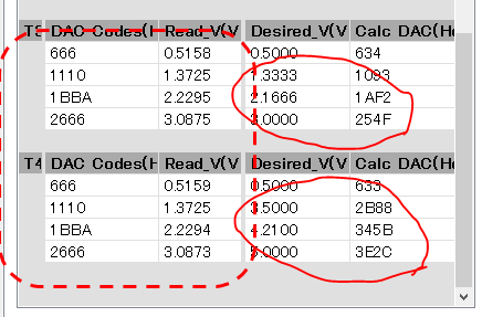

By May 25, could you give me the answer and the judgement value which is the criterion cause this error? In addition, when I tried temperature compensations in 4P-4T, I got same errors it likes 4P-3T errors. Do these errors come from same reasons of the compensation calculation fails in 4P-4T? Please look over an attachment file which is about 4P-4T errors.

    As I mentioned before, the main problem seems to be in the range of the temperature readings. If the range of the temperature readings can be expanded, then the success of the calibration becomes more likely.
    One thing that may be affecting the 4P4T calibration is that for the 4th temperature in the DAC settings, the desired  voltage is not set the same as it is for the rest of the temperature values.
    A represent of this problem sent me wrong DAC screen that 4th temperature is not desirable. I'll send you another later when I got it from the represent.
    Could you show me the AD value for judgement clearly by June 3? I don't know the allowance of difference between each temperature in 4P-3T, yet. Because of this, I can't take adequate measures for this problems. I hope you tell me the AD value for judgements that use for success or error. The AD value for judgement should be used in GUI, and please clear that by June 3.
