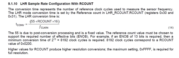

1. SAMPLE RATE

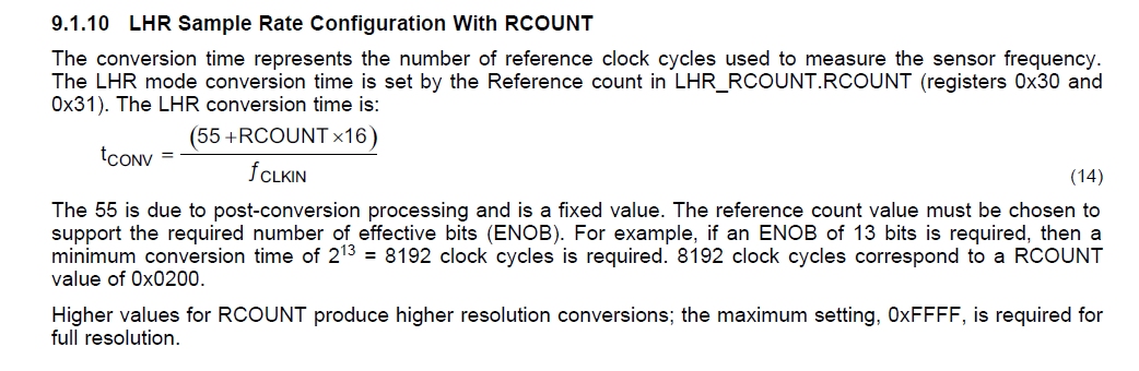

I need to have at least 10kHz sample rate. That gives me from equation 14 (snosd01d):
tconv = 100 usec (total time for conversion)
tpost_conv = 55/16MHz = 3.44 usec (fixed post process time)
tmeas = RCOUNT*16/16MHz =~ 96 usec (time left for measurement, HEX: 0x0060)
sample rate is then 1/tconv = 16000000 / ((3.44+96 * 16)) = 10.394 kHz.
This gives data latency (time from start of measurement to output data reading) 100 usec correct?
2. RCOUNT and RESOLUTION
I understand that with increasing sample rate the effective resolution decreases. Effective resolution is function f(RCOUNT, nominal fsensor, sensor variation,fsensor/fref).
In section LHR Sample Rate Configuration With RCOUNT is an example: 2^13 = 8192 clock cycles then there will be effective resolution will be 13 bits. RCOUNT is calculated as 8192 decimal (btw I believe that 8192 is in HEX: 0x2000 not 0x0200)
How do I get maximum effective resolution of 24 bits if RCOUNT can go just upto 65535?  RCOUNT varies 2^1 (6.5 bits) -> 2^16 (24 bits) but 2^13 is 13 bits?

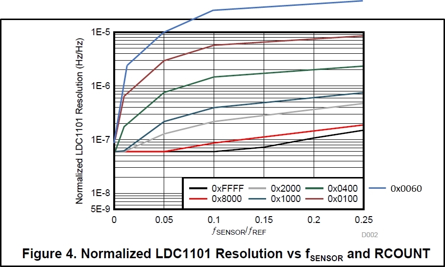

I also read manual snoa944 where on figure 4 is shown normalized resolution. I need to calculate resolution for RCOUNT 96.  What equation is behind this graph at figure 4?
When I extrapolate setting 0x0060 for fsensor/fref 0.05 I get approximate resolution of 1e-5 Hz/Hz which is for fref 16MHz 160Hz (1e-5*16*e6). If I assume that sensor frequency variation is 10% (0.95MHz) then entire resolution is 950000Hz/160Hz = 5937 values =~ 12.5 bits of resolution. Um resolution for range of measurement 2000 um = 2000/2^12.5  = 0.345 um correct?

    Mainly I need to know:
    • How was the graph in manual snoa944 on figure 4 created? I need to calculate resolution for RCOUNT 90.  What equation is behind this graph at figure 4?
    • How do I get maximum effective resolution of 24 bits if RCOUNT can go just upto 65535?  RCOUNT varies 2^1 (6.5 bits) -> 2^16 (24 bits) but 2^13 is 13 bits?
    • When I extrapolate setting 0x0060 for fsensor/fref 0.05 I get approximate resolution of 1e-5 Hz/Hz which is for fref 16MHz 160Hz (1e-5*16*e6). If I assume that sensor frequency variation is 10% (0.95MHz) then entire resolution is 950000Hz/160Hz = 5937 values =~ 12.5 bits of resolution. Um resolution for range of measurement 2000 um = 2000/2^12.5  = 0.345 um correct?

  • Hi Michael,
    Here are the responses.
    A) We dont have specific equation on how the graph that was generated. The information in the document is as is. The data was taken with different Fsensor frequencies with a fixed Fref and measurements were made and summarized with results with varies RCOUNT.
    A) A higher RCOUNT value will certainly increase the resolution. If there is limitation on the RCOUNT the other option to increase the resolution is decrease the sensor frequency. In the graph 4. For RCOUNT = 0xffff at 0.1 fsensor/fref the resolution is < 1e-7 Hz
    A) As the equation to compute isn't present, I cant comment on the extrapolation. Based on the resolution you can achieve that seems correct in terms of the distance measurement.
    Datasheet graph figure 59 also provides guidance on the um resolution as a function of RCOUNT.
    Can you please help us describe more on the application and your target accuracy you are trying to achieve ?

    I see that data in Figure 4 (snoa944) are made of experimental measurement.
    Yes I saw Figure 59 in datasheet with setting 0x00FF.  It can achieve sub micron resolution when fsensor / fref is under 0.1. My RCOUNT setting is 0x005A which is even less time for conversion. The only way is then to keep sensor frequency as low as possible with respect to reference frequency.

  • Hi Michael,
    Keeping the sensor frequency low does provide higher resolution as per the graph. For very high resolution application we do recommend LDC1614 which has a 28 bit data output and can achieve higher resolution. However the principle of sensor frequency vs resolution still applies to LDC1614.
    The internal operations of how the LDC1101 measures frequency is internal IP. What I can share is our LDCs drive the external coil to resonance and as the inductance changes due to change in target interaction the resonance frequency shifts. The change is frequency at resonance with no target and target is recorded and presented at the output pins.
