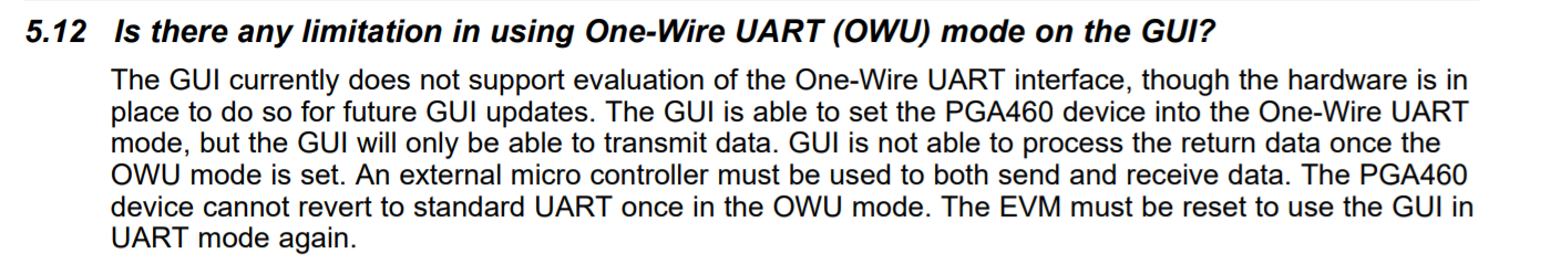

  • Hi Leo,
    Can you confirm how you are obtaining the OWU data that is read from the PGA460?  Just to make sure, are you trying to use the GUI or are you only using the microcontroller for these OWU receive operations?
    Thank you,
    Mekre
  • Hi Mekre,
    All of the operation, parameter data and test result are through GUI interference under both UART and OWU communication mode.
    Leo
  • Hi Leo,
    The GUI does not fully support processing return data when in OWU mode. The following snippet from the PGA460 Frequently Asked Questions (FAQ) and EVM Troubleshooting Guide provides more details on this:
    For an example of OWU, I’d recommend looking at the PGA460 Energia code examples.
    Mekre
