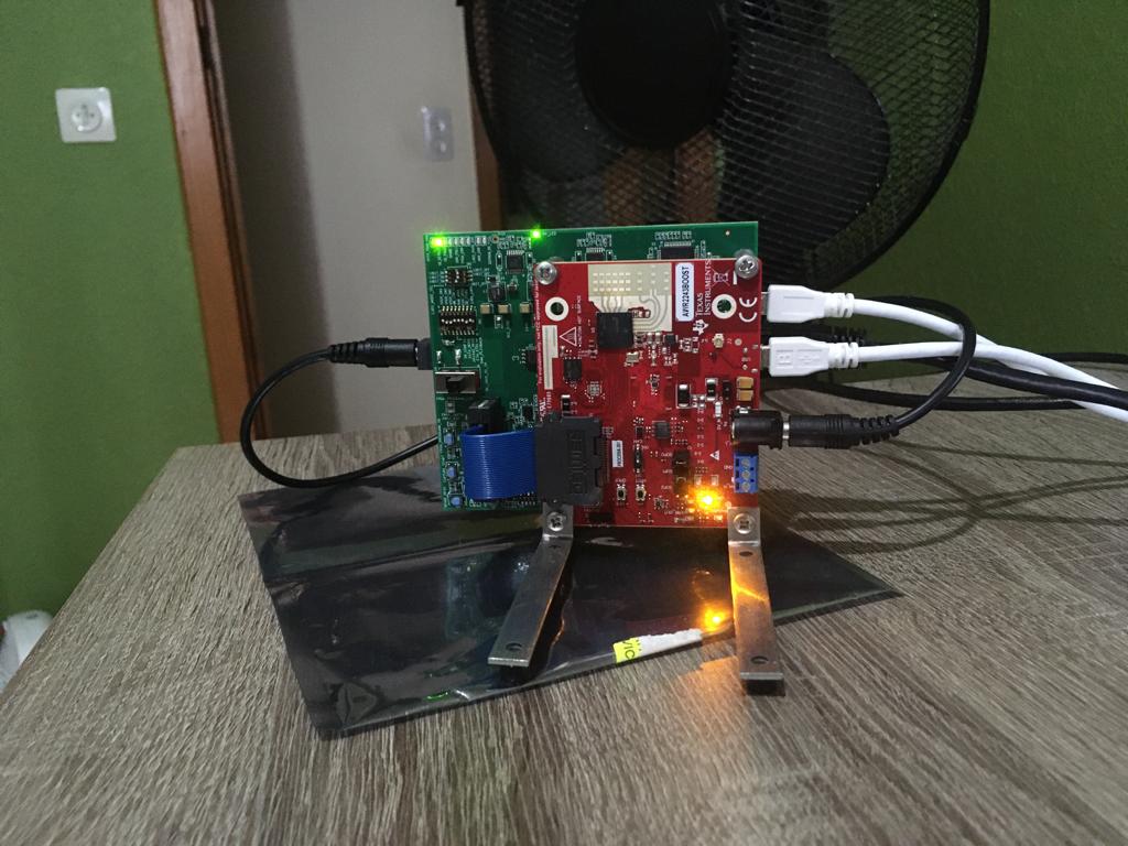

Hi team,
Our customer is encountering an error in using the AWR2243BOOST. The 5v led is not glowing after power-up. The power supply used is 3A 5V. Refer to the attached logs.
Kindly advise for the workaround to prevent the error. Thank you for your assistance.

Carlo

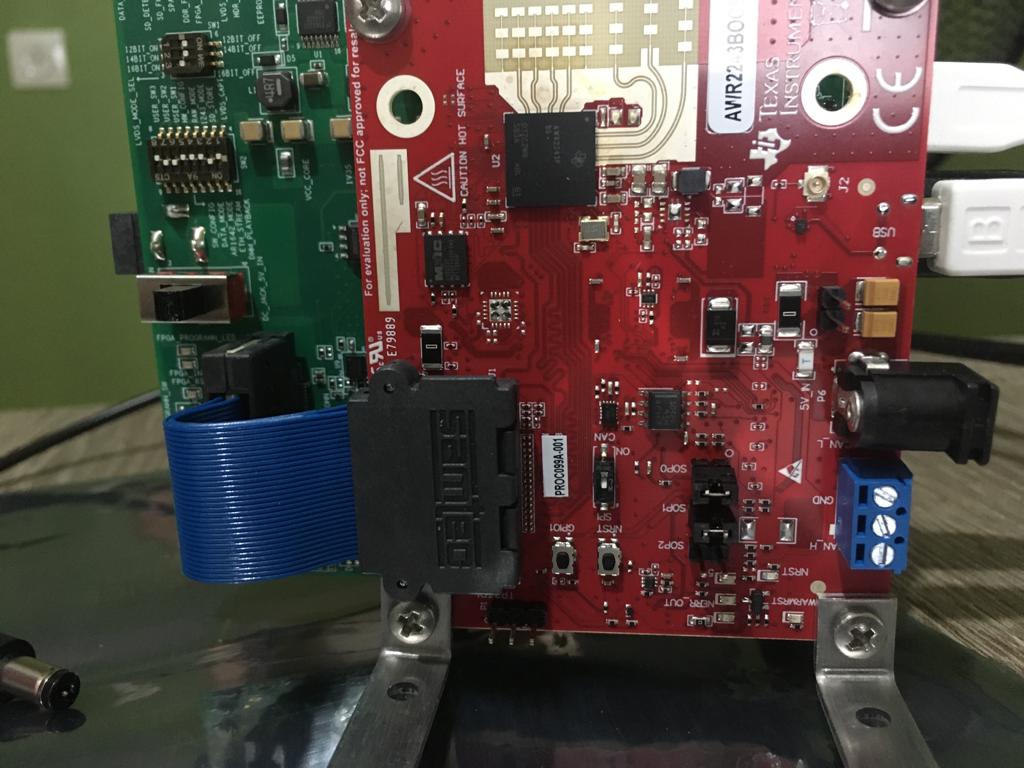

    Other than the LED not glowing, do the COM ports appear in Device Manager?
    thank you
    Cesar
    From your logs the AWR2243 is powering up fine and connecting to mmWave Studio. Your capture is failing because the DCA1000 is failing to connect.
    Please follow the steps in the DCA1000 training video to properly connect the DCA1000.
    Adrian
  • Hi Adrian,
    Thank you for your response. How can the customer set a static IP? Furthermore, he doesn't see the RfDataCapture App as described in slide 14 of the video presentation. How he can call that application from mmWStudio 3?
    Also, kindly take a look at SW1 and SW2 on DCA1000, what switch settings should be used? Among the LEDs on DCA1000 board, SD_DETECT and 5V_LED glow in green color.
    Attached are some of the screenshots provided.
