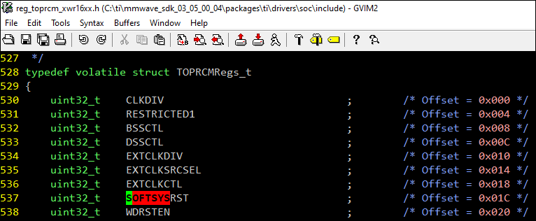

This is in continuation of https://e2e.ti.com/support/sensors/f/1023/t/759919. Nitin has said "The socHandle has references to the SOC register layout, including TOPRCM regs so you can write to the SOFTSYSRST using this structure directly". I don't see any samples of such register writes using socHandle. If TI can provide such a software reset handler, that will be of great use during development phase.

    I need to write the value 0x0000_00AD to the address 0xFFFF_E11C; How do I write to this register?

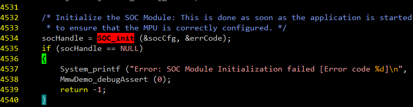

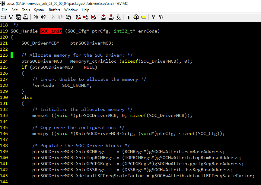

    Please follow the code for the SOC_init call in mss_main.c as shown below. Using this you can understand how to access the required register access from the returned SOC_Handle. You can also write to the register using direct register access as given below
    *(volatile uint32_t*)(0xFFFFE11C) = 0x000000AD.
    -Nitin
