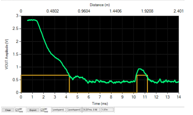

  • Hello Rakesh,
    I made a miscalculation in one of my previous explanations, I'll clarify here:
    with clock in = 100kHz, and CLOCKIN_DIV = 1 (divide by 2), T0 = 2/100kHz = 0.02ms. The maximum timeout  for the standard measurement mode, according to the formula in section 8.4.6.2 is
    with TIMING_REG and TOF_TIMEOUT_CTRL at their maximum values of 1023 and 1024*T0 respectively, the calculated time would be:
    ((1023-30) * 8 * 0.02ms) + 2^(1024*0.02ms) * 128 * 0.02ms = 0.15888 + 0.0025966 seconds ~= 161ms.
    The 8ms value is listed as the maximum timeout duration in the datasheet because although the device is able to support lower frequency transducers, it is not well suited for air-coupled applications with transducers below 1MHz, where the ToF approaches 8ms. 8ms would have been calculated from a 2MHz input clock with CLOCKIN_DIV set to divide by 2, T0 = 1us.
    In an air coupled test with a 220kHz transducer, it was found that the TDC1000 does not have sufficient gain to detect the return echo over an 8ms ToF. We are not able to perform an 8ms+ ToF test in water due to the size of the tank required.
    My recommendation for using the TDC1000 in ToF measurements exceeding 8ms is to disable the timeout and end the measurement manually with a RESET or writing 0x03 to register 0x7, but to justify this, you would need evidence that the return echo can be received at such a distance.
    The TUSS4470 would be a much more feasible and robust device to fulfill your application requirements.
    Logarithmic Amplifier for Ultrasonic Sensor Signal Conditioning
    40kHz transducer:
    Gabriel
