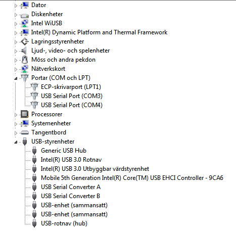

All have in common that the FDTI connection works fine, drivers are installed and that any other connection (RS232 on all available ports and SPI) fails.
At the same point no device is identified (indicating always 0).
In contrast to the four USB devices in the user's guide we have only two, USB Converter A and USB Converter B.

    Looks like your mmWave studio wasn't installed properly or the device is not connected to your pc correct.
    Can you send a picture of your setup and the available COM ports in your device manager window?
    In terms of mmWave Studio Installation, there is no absolutely no difference for a singlechip or a cascaded device, the steps are exactly the same. Just make sure you've all the prerequisites. What is the mmWave studio version you've installed here?
    Also, in cascade if you want to load the firmware over SPI, SOP4 mode is used and no RS232 connection is required in that case. Once your mmWave studio is setup properly, follow the steps provided in the mmWave Studio cascade user guide. But let's look at this at a later stage and get your studio set up first.

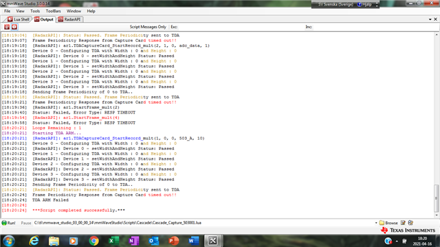

    --> The BSS file used is from the DPF: \firmware\xwr22xx_metaImage.bin. I use this as Masterss and Radarss. Is this ok?
    --> In the "SensorConfig", ARM fails (see attached documents) and the lua script fails as well...

  • Hello Harald,
    Glad to hear you were able to get some of your stuff working.
    Please help me understand a few things :
    1. Are you able to capture data with the default scripts i.e using LUA scripts that come with mmWave studio package?
    2. The errors you're getting above is when you try to setup the GUI manually right?
    As I can see from your screenshots, the TDA width and height is 0, which means there was some configuration that was missed or given wrong.
    Your output logs seem to be incomplete.
    Would it be possible for you to highlight the steps you're doing to capture data using a video or something like that? As you said, its just a matter of a couple of settings and we're just trying to figure out what is that you missed.
    Ishita

  • Hello Harald,
    It is interesting to note that the pair { Cascade_Configuration_ContStream.lua , Cascade_ContStream.lua } scripts work fine but not the { Cascade_Configuration_Basic.lua , Cascade_Capture.lua } pair. Do you know why?
    Cascade_Configuration_Basic.lua script configures the radar device only till "DataConfig" Tab. Before pressing the TDA ARM button, the device needs the profile, chirp and frame configuration as well (a part of "SensorConfig" Tab) which is not a part of that script.
    You can either do that manually in mmWave Studio, or use Cascade_Configuration_TestSource.lua with Cascade_Capture.lua. (In case you don't want to use test source there, just disable the test source in line 50 of that script).
    Ishita

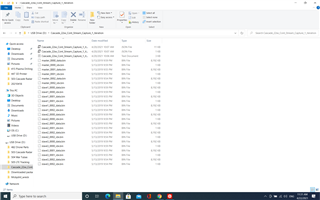

    Now there are three small problems left:
    1: Apparently the radar collects data and there are files transferred to my computer when I run the ContStream scripts. In the JSON files though, it is indicated that there are no captured files are available. It seems that the files that I get from the DSP are always the same and their date is set back to 2019.
    2: There are files copied into a folder with a name that is not equal to the folder name specified in the JSON file.

  • Hello Harald,
    Please find my comments below :
    1. The date of capture in SSD is set somewhere between May/June 2019 and hence you're seeing that, but don't worry about that, the captured files are the latest ones. For confirmation, you can try changing the capture file folder name and after every capture session, you can look for the corresponding files in /mnt/ssd directory.
    Also, regarding the parameter "numFilesCollected" in the setup.json file, it is a don't care parameter and doesn't reflect the capture file status, hence you can ignore that.
    2. "fileBasePath" variable reflects the capture folder name and you should see the name you set. Are you looking at the correct setup.json file here?
    3. The following link that I attached in my previous reply applies to cascade radar as well : https://e2e.ti.com/support/sensors/f/sensors-forum/952458/tidep-01012-raw-data-format-of-tidep-01012/3519917#3519917
    Also, we're very glad to hear that you want to help the entire community with your findings. In case you want to share that, please feel free to post information about that in a new thread and I will mark that as FAQ for our wider audience.
