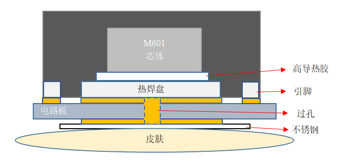

Hi
Is there any structural design reference for TMP117?
PCBlayout, spatial structure, structural material, etc,
thanks!

Hi Neal,
Yes, you can use the TMP117 as shown. Please note the thermal pad must be connected to GND.
