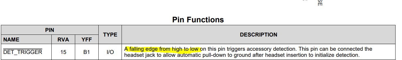

Hi Team,
Would you please help review the TS3A227E schematic and provide your comment?

  • SHH,
    My main concern is note 12 with the DET_TRIGGER pin.  The current schematic has opposite operation.  You can place an inverter in between the phone jack switch and the DET_TRIGGER pin or choose a phone jack with the switch with the opposite operation.

    12. DET_TRIGGER pin to initiate the automatic detection sequence is not connected correctly.  The phone jack looks like it has a normally closed switch that is connected to ground.  This connection will pull the DET_TRIGGER pin low when no headset is in the phone jack.  When the headset is insterted into the phone jack the phone jack switch will open and the DET_TRIGGER pin will go high due to the internal pull up of the TS3A227E.  This operation is opposite of the required operation stated in the datasheet.
