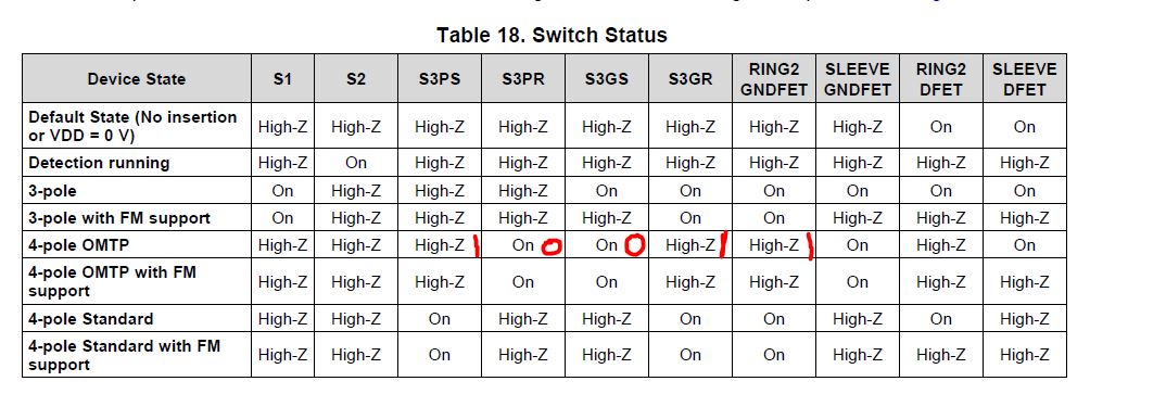

    This is expected if the TS3A227E is configured to support an OMTP device but a CTIA headset is inserted into the audio jack.  You will need to match the TS3A227E internal switch matrix to support the type of headset that is inserted into the jack.
    SWITCH_CONTROL_1=0x14
    SWITCH_CONTROL_2=0x09
    I think you have the bits flipped for OMTP  configuration

  • Dear Adam,
    Thank you for your answer. Your absolutely right, I mixed up OMTP and CTIA settings. Let me put this again into the right context.
    What I'm trying to do is to connect a CTIA headset to the TS3A227E as an OMTP headset so that it doesn't work anymore (I know, it doesn't make a lot of sense). The steps I was expecting to take in order to archive this goal should look like the following:

    What do I miss here? Is this the correct order? TS3A227E manual states that you should set the switches before enabling Manual Switch Control.
    Regards, Thorben
  • Thorben,
    I think the issue in this order in which you are running the experiment. Because you have automatic detection enabled, Any time you insert a headset into the audio jack it will run a detection and reconfigure its switch matrix to support the headset it detected even if you already set the switch matrix manually. You will need to either disable automatic detection or configure the switch matrix manually after you have inserted the headset.
