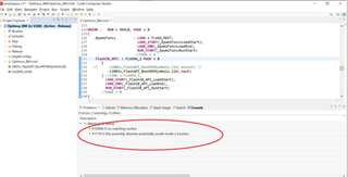

 We got some warnings related with linker file in migrated code. Also got some errors for stack, But we resolved those errors. We captured  warnings in attached document I.e  “Warnings.docx”.

 Regarding the no matching Section diagnostic … This is saying the line …
 -l2803x_FlashAPI_BootROMSymbols.lib(.text)
 … does not match any input Sections.  That line should match all the functions from that library which the main application calls.  Either no functions from that library ever get called, or some earlier specification in the linker command file matches those input sections, and caused them to be part of that earlier output section.  Try making this entire UNION the first thing in the SECTIONS directive.  That would be our first suggestion.
 Regarding the diagnostic about directive potentially unsafe …  The problem is the asm statement with the .label directive in it.  That is a very old way of establishing the load address of an input section.  Perhaps this was recommended back when, but now it is done differently.  Just get rid of it and rely on LOAD_START, and other related operators, in the linker command file.

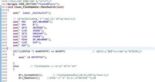

Referring to the email dated 18th Oct 2022 regarding the diagnostic about directive potentially unsafe…..
Request you to share some example on “How to convert below snapshot code into single statement using Load_START in linker command file”.
For my curiosity does the single statement using Load_START for  “.label _MainSwitch” will cover the remaining
Assembly code from line 1417 to 1425, If not then how we can link Assembly code from line 1417 to 1425 to Load_START.
 Below is the snapshot of Section assigned for “Flash28Funcs”
 Please let me know if know any other information.

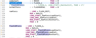

[TI] So we presume the function Class_FlashUpdate::MainSwitch is the only one in the input section Flash28Funcs.   In that case, comment out the .label line and write this in the linker command file …
     Flash28Funcs : > FLASHA_1, LOAD_START(_MainSwitch), PAGE = 0
 That does the same thing.
 Note this presumes there is code elsewhere that uses the symbol _MainSwitch.  It seems that code also needs to know the run address and the length.  However, in the original implementation, I cannot see how those details are handled, so I don’t mention them here implicitly.

We appreciate your support!!  So continue on previous mail query, for “Class_FlashUpdate::MainSwitch” there are 18 method kept at location shown in below screenshot.
 we tried above method by taking reference to example provided in previous mail i.e.  (Necessary commenting of assembly (_MainSwitch) and extern of these new Load start, end and run also done along with copying this section on Ram by necessary method.)  and the link you have shared snapshot is attached. But even it did not worked.
