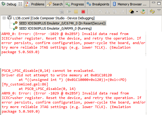

An error has been found when trying to set L138 ARM core into wait-for-interrupt sleep mode with the following ccs 5.1.1.00031 console message:
ARM9_0: Error: (Error -1029 @ 0x2B5F) Invalid data read from ICECrusher register. Reset the device, and retry the operation. If error persists, confirm configuration, power-cycle the board, and/or try more reliable JTAG settings (e.g. lower TCLK). (Emulation package 5.0.569.0)
C code below, modified on the basis of evmomapl138 initialization gel, is used to set ARM core’s PSC to “disable”,

And such code was invoked on the DSP side using
PSC0_LPSC_disable(0,14);
On the ARM side, an ISR corresponding to ARMCLKSTOPREQ event has been set, and has been tested to be responsive by manually setting bit 26 (26+64(start index of SRSR3)=90, the interrupt number of ARMCLKSTOPREQ) of AINTC.SRSR3 register and observing that the ISR would be triggered. However, problem arises when trying to completing the process by:
1.    Turning PSC0 ARM module to wait-for-interrupt sleep on the DSP side.
2.    Expect the triggered ARMCLKSTOPREQ ISR on the ARM core to execute the MCR p15, #0, r3, c7, c0, #4 command to put the ARM core into WFI sleep.
As soon as DSP executes PSC0_LPSC_disable(0,14), the error message in red font immediately appears in the console window. The status of the emulator connection to DSP core would be “In reset(secure)”, and the status of ARM connection would be “running”.

  • Also regarding the wiki link JohnS referred:
    The fist of its suggestion is to use code rather than GEL for changing the PLL:
    http://processors.wiki.ti.com/index.php/XDS100#Q:_My_XDS100v2_does_not_work_reliabily_with_the_OMAPL138_.2F_DM365_.2F_ARM926_core said:
    A couple of things to try:
    1. Setup the PLL by executing code (ex: UBoot, etc.) instead of using the GEL file. (preferred)
    2. Turn on adaptive clocking XDS100#Q:_How_can_I_turn_on_adaptive_clocking.3F and setup the timeouts to very slow. In this mode, it is still better to "run" the code and not "step" it.
    3. Make sure you have the latest CPLD version. To update the XDS100v2 CPLD, please see XDS100#Q:_How_can_I_update_the_CPLD_on_my_XDS100v2.3F
    I have tried both code and GEL methods, and the error message when disabling ARM PSC can be seen at the lower half the the screenshot attached above. The error exists regardless of the GEL/code choice.
