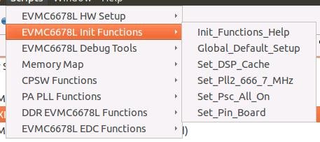

I presume you have associated the GEL script evmc6678l.gel with core0 (or more) in your target configuration. This means you will have several GEL script commands you can run. One of them is Global_Default_Setup. Select Scripts | EVMC6678L Init Functions | Global_Default_Setup. See the screenshot below. That should help.

I haven't associated the Gel script to the cores as I assumed I can run the example as described in the Tutorial (Link). I have now done this according to the instructions in this post for core 0-3. Is that ok?
The Global_Default_Setup is then run already when I start debugging. But I rerun it as you described. The error: "[C66xx_1] ERROR: Ipc_start failed in OpenMP_masterTask" does not arrive anymore, thats fine.
