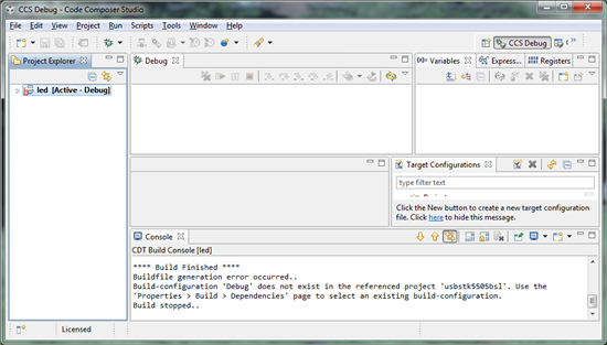

Now I wanted to import the v4 LED sample as a projekt and wanted to make the build command, then the following error came up
Build-configuration 'Debug' does not exist ...

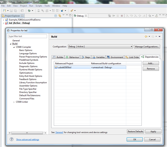

  • Hi Dieter,
    thanks for sending that.  I was able to reproduce the issue and this is how you work around/correct it.
    You also need to import the usbstk5505bsl project into the workspace and make sure that the led project has dependencies on it.
    You can import the usbstk5505bsl project in the same manner (project->import exsisting ccs/eclipse project).
    You can add/verify the dependecy by making sure the led project is selected and going to project->properties->CCS Build-> dependencies tab
    Please give the above a try and keep us informed.  When I build I still end up with a couple warnings but no errors and no error about the debug configuration.

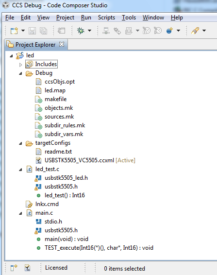

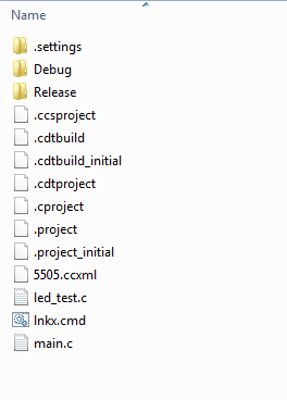

  • Hello Lisa,
    I worked again at the issue this weekend and still without any success.
    I did the following: On my notebook with CCSv4 and Win XP I exported the LED project. Content is visible in the last pic. Then I imported the whole project to the other notebook with CCSv5 and Win 7 / 64 Bit.
    After the Build project I have a screen like the upper pic with the build error message again. I have to explain, that the files which are listed in the build message console, are with the German sentence "xxx konnte nicht gefunden werden", which means "xxx could not be found." The paths are exactly how I placed the project files.
    The middle picture shows the build dependencies properties, which I selected and activated.

    next try, two weeks later. Sorry, I get always the same result with no success. To import from the project menu is not possible at all in my CCS. I imported only from File/import. But this way I encounter always the same result. To import I just have the shown files available. There must be something missing, but what, I don't know.
    I imported a project for the Piccolo LaunchPad 2000 from the control suite, but there are no examples for the eZdsp kit and no LED project either.
    Best regards
    Dieter
  • Hello Lisa,
    that is what I get, when open the Dependendies:
    I selected this "Dependency" and made a build, but still with the sdame problem.
    Best regards
    Dieter
  • Hi Dieter,
    did you import the usb library project?  I don't see it as a listed project.
    Lisa
