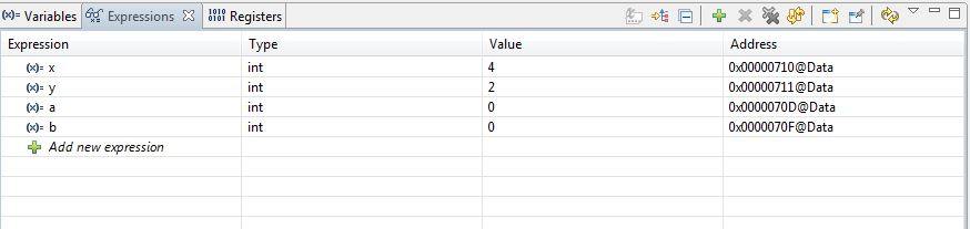

Dear All,
         I am using CCSv5.4,in Windows Xp. I have written code in TMS320F28035. While in the execution of this code i had face the problem as follows:
Code Snippet:
    if(x>y)
 a = 1 ;
 b = 2;
In the above snippet a=1; line was not executing in Free Run Mode. But if i place a break point it will halts there and 'a' was assigning with 1.
For this i interchange the equation a=1; and b=2; now b=2 was not executed.
    if(x>y)
 a = 1 ;
    if(x>y)
 b = 2;
If i wrote these conditions separately  its working fine. Why?
Note: I never use a & b in other locations.

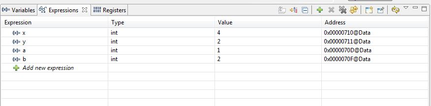

  • Hi Naresh,
    I hope you've declared a and b globally as int16 datatype.
    I too check the same on my C2000 launchpad:
    Uint16 x=4,y=2,a=0,b=0;
    //In main added the following lines
    if(x>y)
                a=1;
                b=2;
    Here are the screenshots of the Watch window before Free Run and after Free Run:
    So, I don't think there should be any kind of skipping as you're experiencing.
    Gautam
