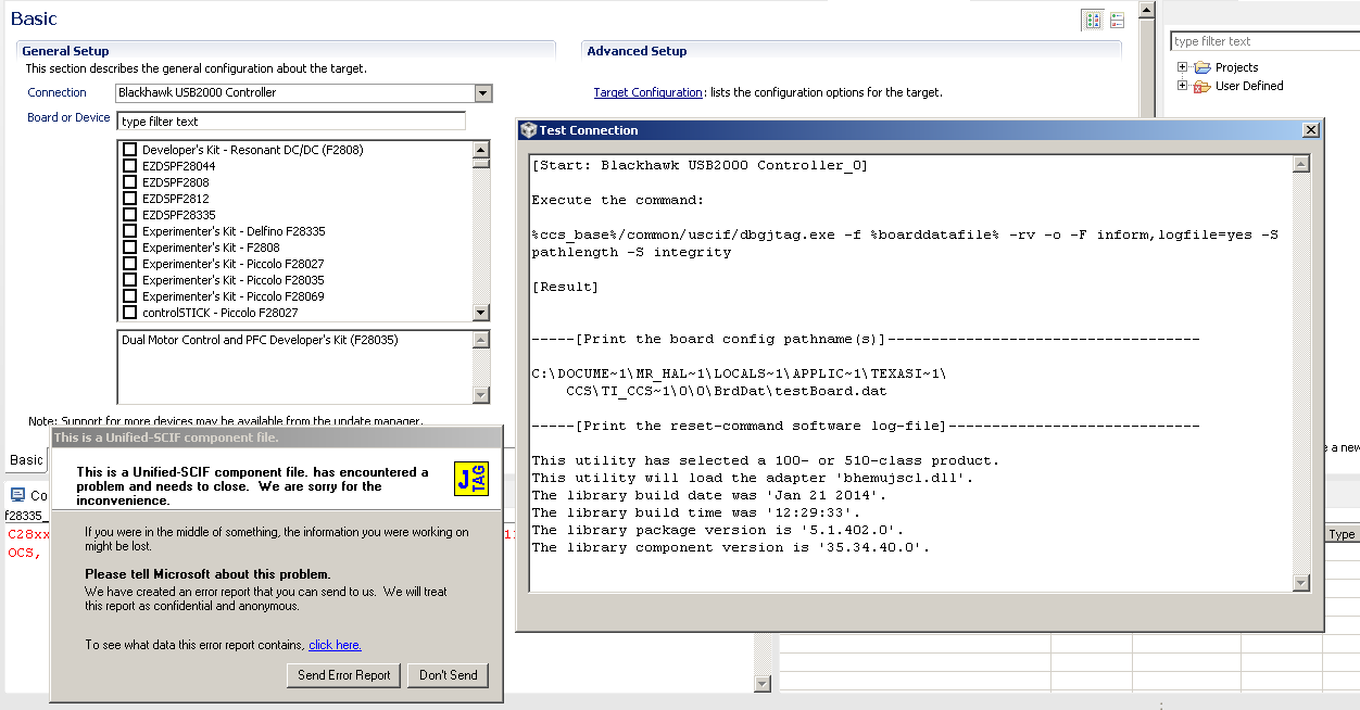

    1) Attempting to test the connection failed,since it caused the dbgjtag.exe to crash:
    2) Attempting to connect using the Blackhawk USB2000 caused CCS 6 to crash (and exit without any error messages).

    I launched one session (the 28035 project) and then did a test connection on the 28335 project. Nothing crashes, but the log doesn't look very promising (please see the printout below). If I launch the Blackhawk control panel both devices appear and look healthy. The CCS updater can't seem to find any more updates.
    [Start]
    Execute the command:
    %ccs_base%/common/uscif/dbgjtag.exe -f %boarddatafile% -rv -o -F inform,logfile=yes -S pathlength -S integrity
    [Result]
    -----[Print the board config pathname(s)]------------------------------------
    C:\Users\johwol\AppData\Local\.TI\693494126\
        0\1\BrdDat\testBoard.dat
    -----[Print the reset-command software log-file]-----------------------------
    This utility has selected a 100- or 510-class product.
    This utility will load the adapter 'bhemujscl.dll'.
    An already open status was returned while soft opening the controller.
    -----[An error has occurred and this utility has aborted]--------------------
    This error is generated by TI's USCIF driver or utilities.
    The value is '-110' (0xffffff92).
    The title is 'SC_ERR_OCS_ALREADY_OPEN'.
    The explanation is:
    This utility opened the controller but found it already in use.
    You must exit other debuggers and utilities that access the
    controller because this utility must be the only client.
    [End]
