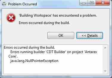

Since this morning, I faced an error when trying to build my workspace.
I tried to restart CCS and to restart my laptop. Nothing change, I cannot build anything.

In the log file I attached, you should go at the end of file to see latest error :
!ENTRY org.eclipse.core.resources 4 75 2014-02-25 10:42:26.140
!MESSAGE Errors occurred during the build.
!SUBENTRY 1 org.eclipse.cdt.managedbuilder.core 4 75 2014-02-25 10:42:26.140
!MESSAGE Errors running builder 'CDT Builder' on project 'Antares Core'.
!STACK 0
java.lang.NullPointerException

Hi Remi,
There was a project corruption issue in earlier CCS v5 builds, which was fixed in CCS v5.5.0. See this post for more details: http://e2e.ti.com/support/development_tools/code_composer_studio/f/81/t/226067.aspx .
Your project is already corrupted at this point. If you can, please revert your .cproject file, and then upgrade to CCS v5.5.0.
If you cannot revert the .cproject file, could you attach that file here? I will see if I can fix the corruption manually.
