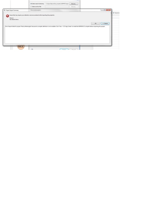

HI All,
when i try to import my old program i get this error.
i have tried to find the download for the MSP430v3.3 compiler but no success.
I am able to get a compiler from my old v4 versions of CCS and it says i have the v3.3.3 compiler but it wont let me import.
Thanks in advance,
Steven

  • Hi Steven,
    Are all the files present? This happens when a file goes missing!
    Gautam
    thank you for the quick response. all the files are present. I had been previously able to import the CCS project into the CCS v6 no problem. at that time i got a build error of a very similar message.
    i then went into the compilers and added the v3.3.3 from my CCS v4 version. i also downloaded the CCS v3.3 but it did not have a valid compiler to add.
    I opened CCS v6 the other day and the project had an x marking an error saying that a "make path" was missing.
    i have a backup of the entire project which i originally duplicated when i upgraded to CCS v6. that backup gives the same message.
    What else could i try? it says go to the app center to download msp430v3.3 but i can not find that compiler anywhere...
    Thanks again for you help!
  • i also tried re installing the CCS 6 with no success but then i erased all of the compiler directory's inside preferences and put them back. i had done this already but this time i got a message that the changes would take affect on the next start up of CCS v6 and now it imported fine.
    thanks again!
