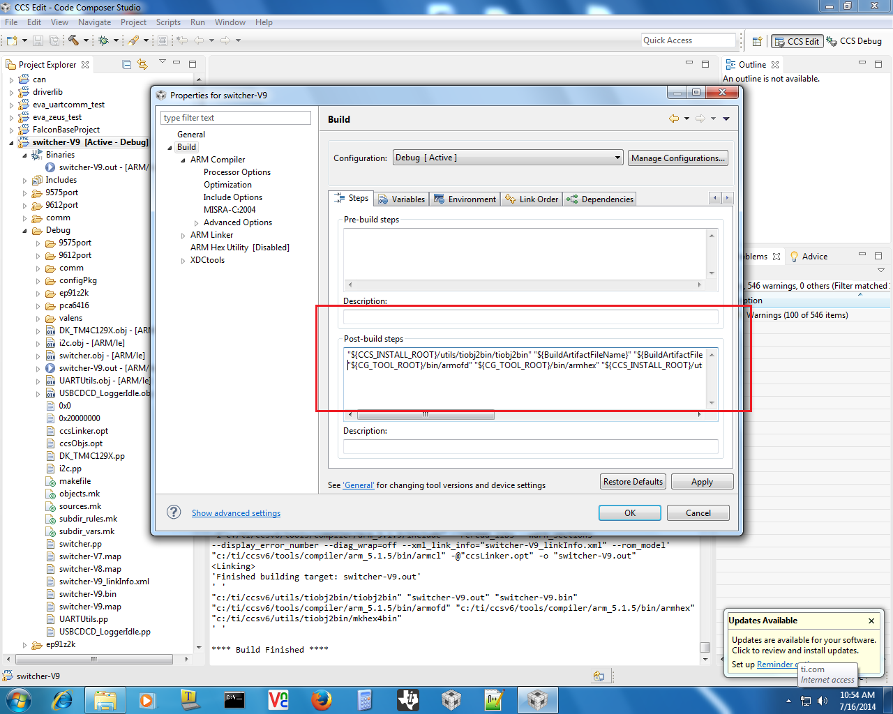

Can someone direct me to a way to create a .bin file in CCSV6? This is for a Tiva TM4C129. LM Flash Programmer requires a .bin file. I've looked through the posts and nothing seems to answer this question for my specific environment. A possible exception is one post saying to use tiobj2bin. When I try this, I see the following output:
C:\ti\ccsv6\utils\tiobj2bin>tiobj2bin a.out a.bin
-------------- Error message mentioning wiki here ---------------
'armofd' is not recognized as an internal or external command,
operable program or batch file.
File does not exist: at XML_TI_OFD.pm line 877
'armhex' is not recognized as an internal or external command,

Following these steps for post build results in the same errors I put in the original post, where I was doing it manually:
"c:/ti/ccsv6/utils/tiobj2bin/tiobj2bin" "switcher-V9.out" "switcher-V9.bin"
PC\workspace_v6_0\switcher-V9\Debug\==c:\ti\ccsv6\utils\tiobj2bin\ was unexpected at this time.
gmake[1]: [post-build] Error 255 (ignored)
"c:/ti/ccsv6/tools/compiler/arm_5.1.6/bin/armofd" "c:/ti/ccsv6/tools/compiler/arm_5.1.6/bin/armhex" "c:/ti/ccsv6/utils/tiobj2bin/mkhex4bin"
error: failed to read "c:/ti/ccsv6/tools/compiler/arm_5.1.6/bin/armhex"
error: failed to read "c:/ti/ccsv6/utils/tiobj2bin/mkhex4bin"
gmake[1]: [post-build] Error 1 (ignored)

Hello Don,
Got it working now. Also figured out why the bin file is not getting generated. The Post Build Steps have to be a single line.
I have attached the original snapshot of the project settings (which was giving error and no bin file)
I have attached the new snapshot of the project settings (which is not giving error and generating the bin file)
Amit
