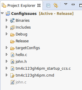

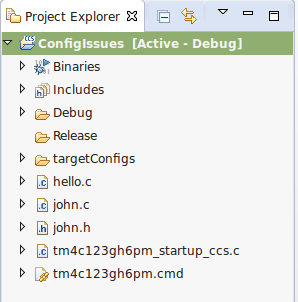

    Here is my Debug configuration.  You can see that john.c is included in the configuration.
    Here is my release configuration.  You can see that john.c is excluded.

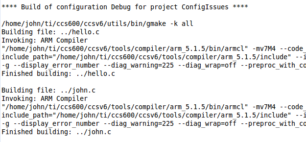

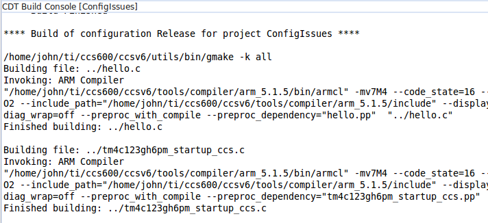

    Here is the output when I build the Debug config.  You can see that john.c is built.

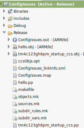

    Now here is the output when I build the release configuration.  John.c is not built.
    Further if I look in the Release config folder there is no obj file for john.

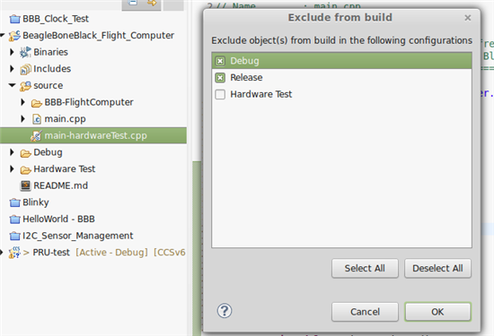

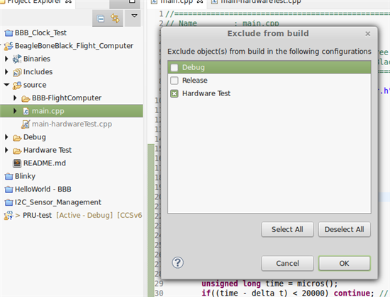

  • Ok, here are some screenshots of my steps. I am also attaching a copy of my project directory.

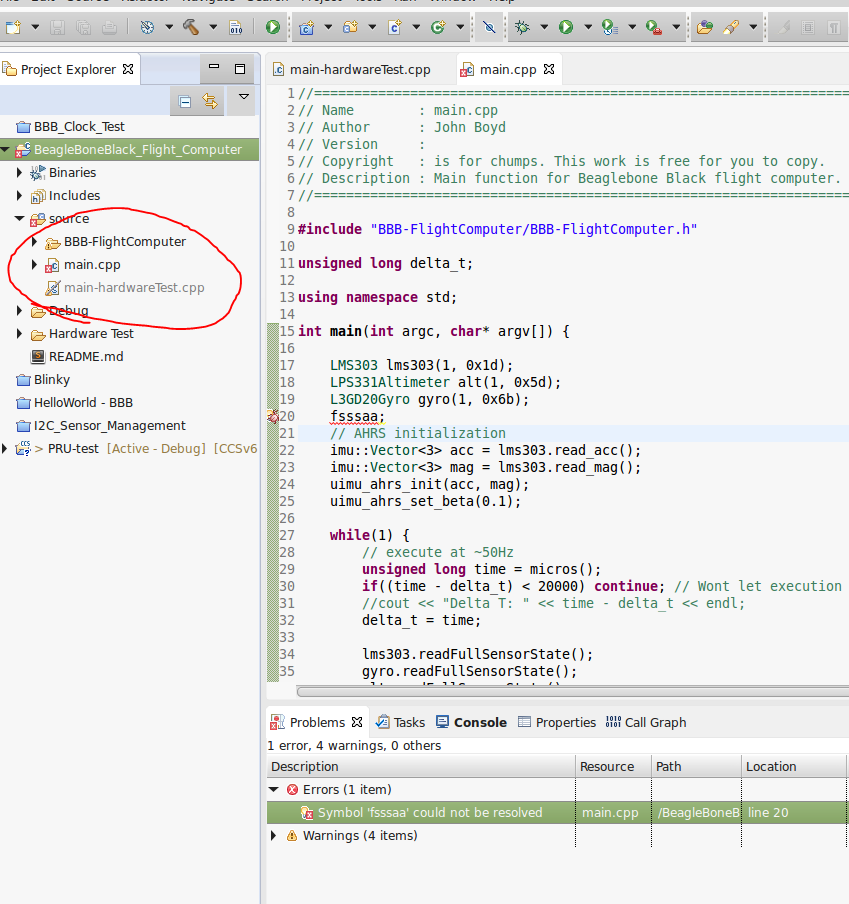

    I created a build configuration called "Hardware test". I then excluded "main.cpp" from that build configuration:
    I then made sure "main-hardwareTest.cpp" was not excluded from this build configuration and was excluded from the others:

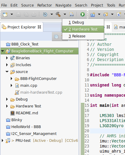

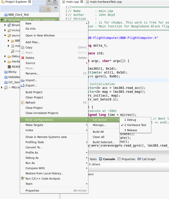

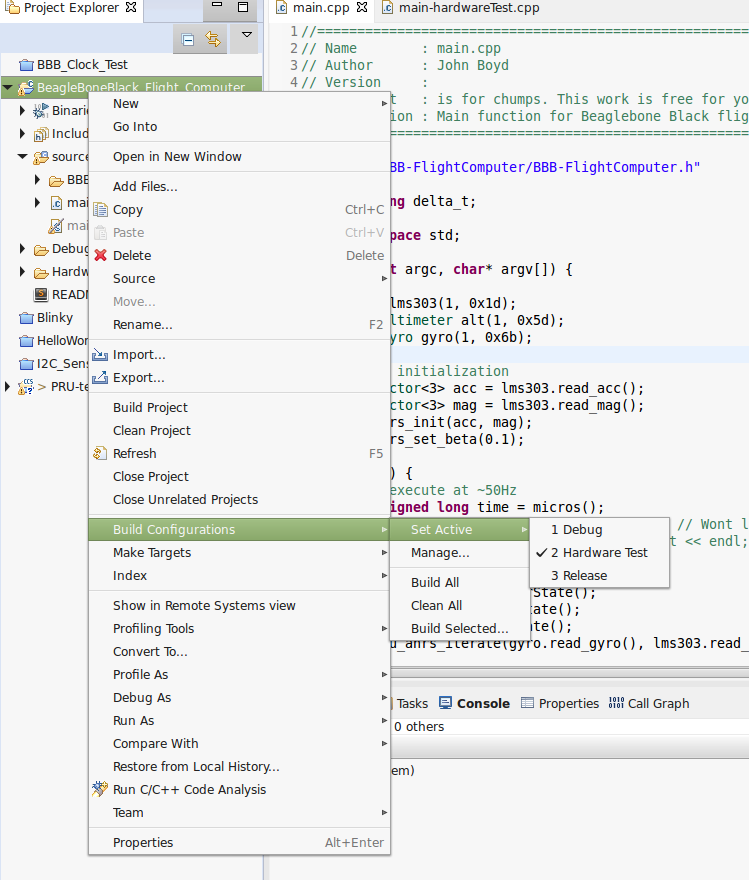

     I then made sure that I had selected the "Hardware Test" build configuration:
    Finally I selected build>hardware test from the build drop down menu: (immediately you can see that the wrong main file is grayed out in the project explorer.)

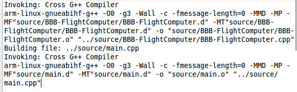

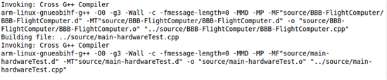

    I made sure that the "main.cpp" file had an error in it, so if it was compiled, it would throw an error and I would know that it compiled the wrong file:
    I checked the console output though, and it makes no mention of building the unwanted main.cpp file:

  • I will update my install to include Sitara support and give the project a try shortly.  You are using a slightly different method to exclude files but I just gave that a try on my project and it was ok so that didn't matter.
    One thing I noticed that is a bit different is that your PRU project is being listed as active in the project explorer vs the project for the A8.  That may be why you are seeing the wrong file as excluded.  Make your project explorer a bit wider and then click on the A8 project.  It should list the config that it is displaying information for.
    I will have an update in a few hours.
  • Yeah, I accidentally forgot to close out my PRU project when I was taking screenshots for you. I have tried this several times though with the A8 project being the only open project, and still had the same problems, so I dont think that is the cause.

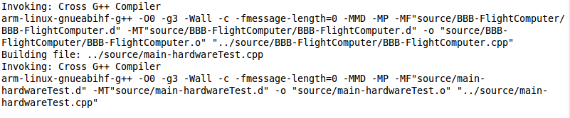

  • The first thing I noticed when I imported the project is that it is not a CCS project but instead an Eclipse C project.  Thus the behaviour could be a bit different.  This is probably also why the exclusion stuff is messed up in the project explorer.  When I look at what it is showing it lists the config as "master" vs the actual config name.  Thus it is not showing the proper settings for the active config.
    I don't have your version of gcc installed so I changed the project to not stop on the first error as I get an error on each file.
    Here is what I see when set the active config to Debug and build.
    main.cpp gets built but not the main-hardwaretest version which is what is expected.
    Now I set the active config to hardware test and then build.
    Here main.cpp was not built but main-hardwaretest.cpp was.
    Thus for me it does seem to be working correctly
