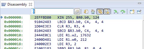

I load the same program into a PRU (AM335x) in CCS5 and CCS6.
After that I want to step trough my code. In CCS5 I have a disassembly view with addresses matching to my "listing.lst" output of PASM.

In CCS5 disassembly window it looks like this:
In CCS6 it looks like this:
It's very hard to debug, without matching addresses of disassembly and listing...

  • Hi John
    It's not the problem with the radix prefix. My problem is the different address-increment. In CCS5 its 1 and it fits to the listing-files generated by PASM. In CCS6 the increment is 4.
    Regards, Matthias
  • When I generate a listing file I see the same as what I see in the disassembly.
    I am not very familiar with PRU but after doing a search I believe I know what the problem is.  The disassembler in CCSv6 is built for use with the TI PRU C Compiler/Assember... toolchain.  This toolchain comes from the development tools team in TI.  There was also an older assembler that came from another group.  This is called PASM and is what you are using.

  • Hi John
    Yes, this is my problem. At the moment we are chanching from PASM to the C-Compiler. But when I'm working with the old toolchain I' have the problem with the different "addressing format".
    Is there a possibility to configure PASM to generate files with an address increment of 4?
    regards, Matthias
