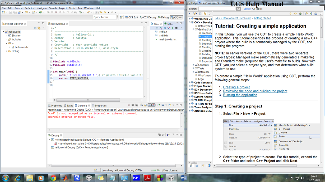

Hi, I have started to learn CCSv6 and it was good experience until I got "'cmd' is not recognized as an internal or external command, operable program or batch file" problem. I am creating C/C++ hello world project and follows exact procedure as explained in CCS Getting Started help guide. I am using MinGW compiler. What could be possible solution? please suggest me..

    attached figure contain both help manual and ccs error message

    This seems to indicate the build completed without errors. Does the error appear at run time then?
    On which target/device are you running the program? It appears that you are running a C/C++ Remote Application debug session so is it your intention to run the app on Linux and debug with CCS? This scenario is mostly used when debugging a linux-hosted executable.

  • The default type of project in Code Composer Studio is a CCS project. This type of project is specifically targeted towards a TI embedded processor and uses TI compiler/build tools to build the project. The general process most users go through to get started is to create and build a CCS project targeted for a specific TI device (it could be a Hello World or Blink LED type of project) and then load and debug the code on a TI kit. In older versions of CCS (v5) we included simulators on which you could run the code if you did not have access to a hardware kit. In CCSv6 simulators are no longer included due to the availability of many low cost development kits or launchpads, so you would need to have a board/kit to be able to run a program.
    The Help section you referred to allows you to create C/C++ Eclipse projects and use an external toolchain such as GCC or MinGW. For a bare-metal program (one without an OS) you would still need to connect to a target board (usually through a JTAG connection) in order to download and run the code.

  • LAXMI KANT TIWARI said:
    I am sorry to ask again but help section didn't give solution. just I want to know where am I wrong?
    You are using CCS to compile and debug a native Windows program, rather than a TI embedded device (which is what CCS is designed for).
    In order to debug a native Windows executable I think you need enable "CDT GDB debugging" in CCS as detailed on develop a PC application with CCS
    I haven't yet tried to debug a native Windows executable under CCS 6, but enabling "CDT GDB debugging" as per the referenced thread has just allowed me to debug a native Linux executable with CCS 6 running under Linux.
