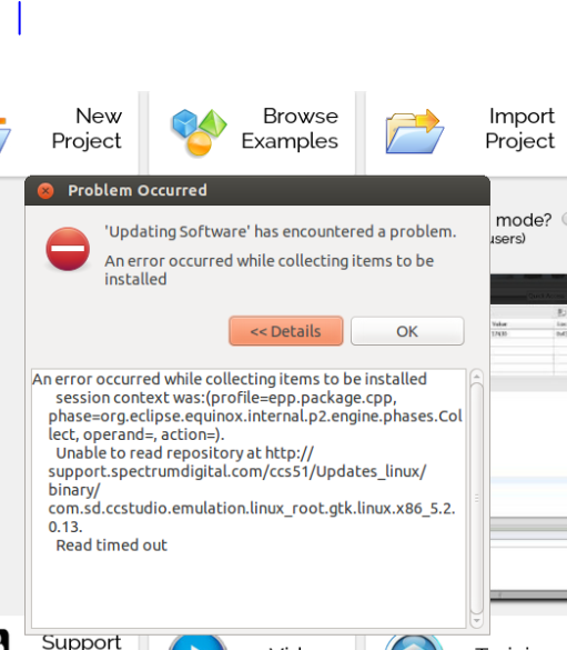

Here is the error I am getting for 2 days in a row...
Any idea why I am getting it?
Yesterday's update also rendered my Windows 7-64bit based CCS6 hanging when being clicked for connect the target, and I am stuck with it.
Any help would be appreciated.
danishinnis said:It looks like the third party site for Spectrum digital may be unavailable. Please unselect the Spectrum digital update and try again.
Unselecting made the updating completed.
THANK YOU!
