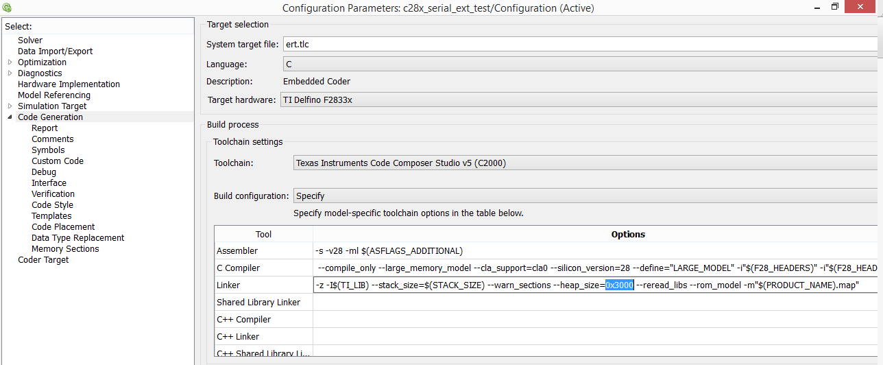

I have contacted the Matlab Support and they answered:
"1. The documentation you are referring to is for R2015a.
2. The MATLAB you are working with in R2014b.
3. The capability for 'Signal Monitoring and Parameter Tuning with External Mode' is available from R2015a, so that is why you do not have the option."
So, I upgraded to R2015a and there is the function and it works !!!
Now, I have a second question:
In the matlab link I have sent, stands:
"Increasing the Duration allows the capture of large real-time buffers. These buffers use heap section to allocate memory. A high value of Duration may result in Not enough memory on the target to process the packet warning, and consequently cause no data to be uploaded from the target to the host computer. To overcome this warning, specify a larger heap size if your target has sufficient memory. To change the heap size, go to the Model Configuration Parameters > Code Generation > Build Configuration > Specifyand modify the value for the option '--heap_size'."
When I increase the "Duration" to much, then the mentioned error occurs:
When I increase the "heap size" to much (over 0x3000), then the following error occurs during the building process:
Failed to generate all binary outputs
Is there any possibilty to enlarge the "heap size" ???

Hello Mr. Charantimath,
I'm sorry that I haven't answered so far !!!
Your solution works fine !!!
My RAMM1 in PAGE 1 hasn't much memory size (see Memory Configuration below). Now I'm unsure which of the other memory sections I can use for adding to the heap area.
For example, can I use ZONE7D in PAGE 1 for heap, because this has got a big length and is unused???
Thanks a lot
Jonas Blau

Hi Jonas
Nice to hear that the solutions works for you.
Regarding the ZONE7D, this section belongs to the external RAM. (look up for ZONE7D in the .cmd file. It is placed in the external_ram section)
So the answer is subjective. You can use this, only if you have external RAM interfaced to the c28335.
Thanks.
Amit Charantimath
Hello Amit,
I have overlooked that the ZONE7D is placed in the external_ram section!
But my question for more RAM is still remaining. How can I get more RAM (besides using external RAM) ??? Or is that not possible?
