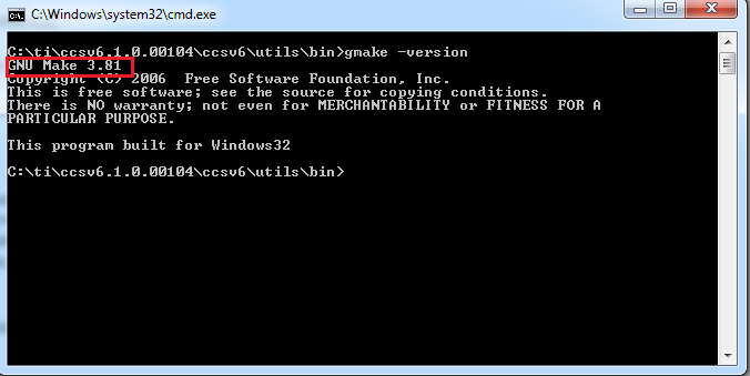

    CCSv6 comes with gmake 3.81. Where are you seeing version 3.78?

    I ran command prompt in the C:\ti\ccsv6\utils\bin folder and that returned a version of 3.78.
    I will try a compete reinstall and see what version that installs.
    If it's 3.81 that solves my Tiva compiling, will have to look further into my MSP430.
  • I did complete reinstall and verified that gmake is version 3.81 in the ccsv6 install directory.
    However I can also verify that the original install put 3.78 in the directory.
    My initial install was ccsV6 not 6.1 but definitely had gmake 3.78.
    Now with clean install it is all up to date at 3.81 and I will research possible other gmake in path interfering with my msp430 buil.
    Thanks for your response.
  • I'm not sure how you got gmake v3.78 in your old install. We moved to gmake 3.81 ago... I believe with CCSv5... maybe even earlier. In any case good to hear your environment is good now.
