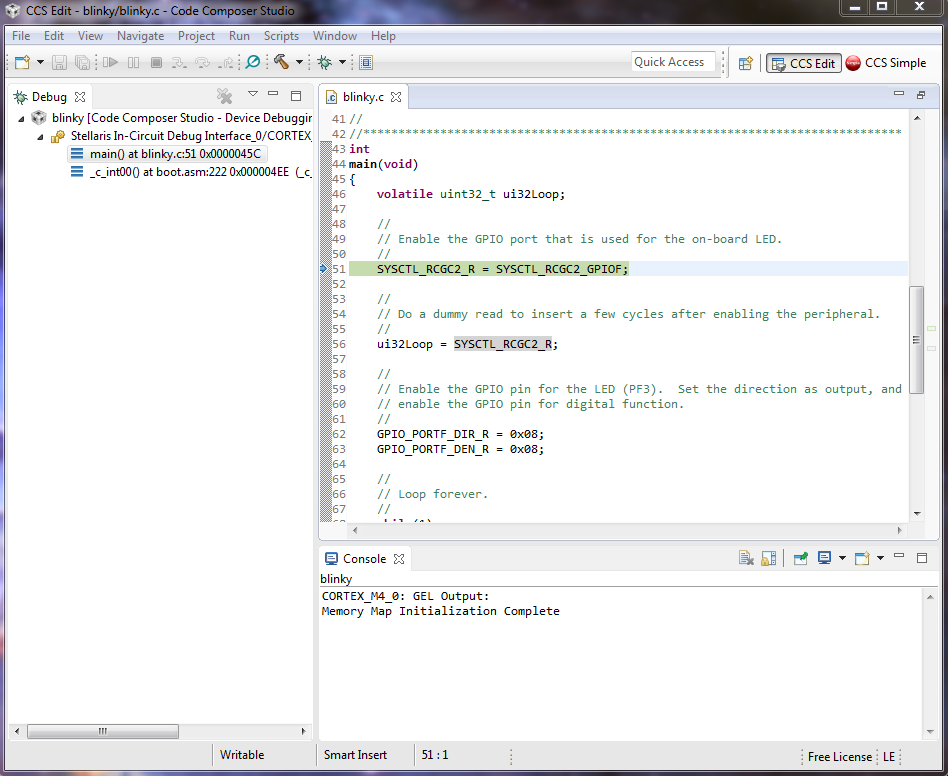

I am trying to run the 'blinky' example program in CCSv6. The target board is the TM4C1294XL Launchpad Rev D. When I click 'Debug', it enters the main() function and then halts. Normally I would press 'Resume' at this point but all of the play/stop/step buttons are grayed out. Can someone explain why these buttons are grayed out?

If you ever used CCS Simple to debug the code (which it appears that you did), then you are hitting a known issue we are aware of, being tracked in bug # SDSCM00051770.
Please see this post for details and how to workaround it: https://e2e.ti.com/support/development_tools/code_composer_studio/f/81/p/410823/1471704#1471704
This issue should be fixed for the next update CCS 6.1.1.
