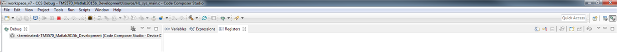

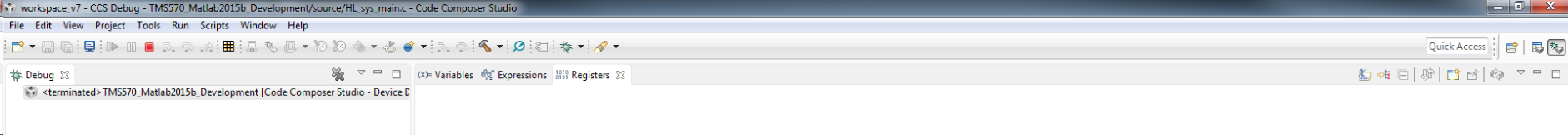

thanks for your quick response and your hints.
Unfortunately the Debug view is open (see attached screen shot)
The problem seems to be the HW. This morning I tried another TMDX570LC43HDK and it worked perfectly well.
In the screenshot above, you can see that the debug session was terminated (note the "<terminated>" tag in front of the highlighted node in the Debug view). Since the debugger has been terminated, you cannot do any debug actions.
