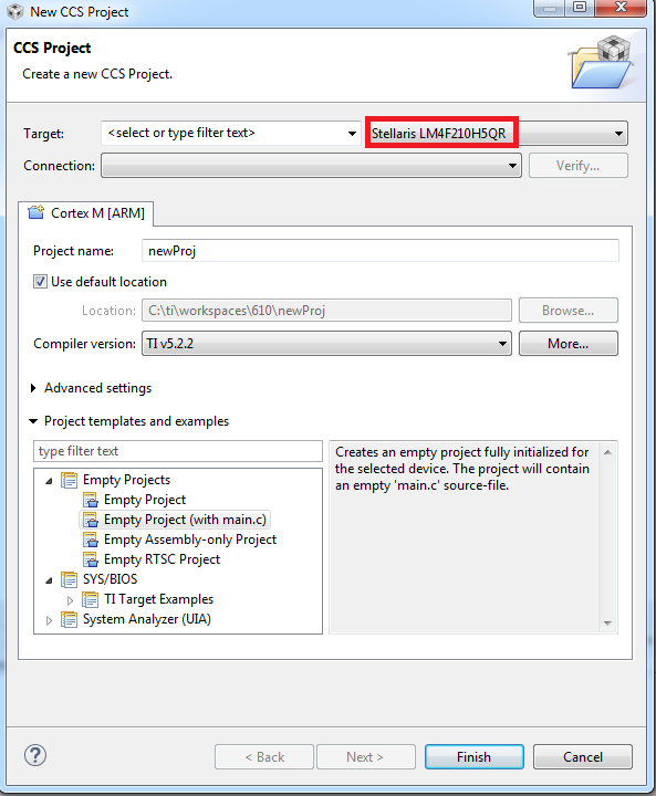

stellaris launchpad lm4f support on ccs6.1 --- how do I start a 'new project'
Dear FORUM,
I want to do some work on LM4F120 H5QR   ---   yes this is the TI Stellaris Launchpad   ---   just need to do some S/W maintenance after a couple of years.
QUESTION ---    how do I start a new project in CCS 6.1 for Stellaris LM4F  ????
I miss the ease of starting it up since I last used it in CCS v 5 days.     And before TIVA.      And is Stellaris / ARM compiler still unlimited code size  -  or 32K code size???
Thank you for your patience in answering this 'legacy product' question !!
Cheers.
  • Hello Otto,
    To start a brand new project, go to 'Project -> New CCS Project' and use the New Project Wizard to create your project:
    There is no code size limit. And there is no restriction at all (debugging) if you are using the LaunchPad with the integrated debug connection (Stellaris ICDI I believe).
