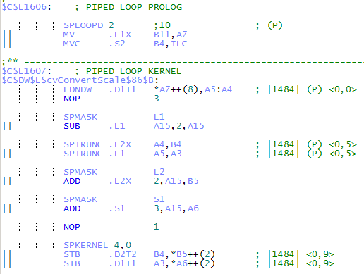

I had this original line of code, where pRowSrcf is a float pointer and pRowDstu is a uint8_t pointer (this line is
executed in a 'for' loop):
        *pRowDstu++ = (uint8_t)*pRowSrcf++;
When the original line was replaced with below two lines as shown below:
          int iVal = (int)*pRowSrcf++;
          *pRowDstu++ = iVal;
there was a 10x increase in performance. I have attached the generated .asm code for each case and screenshot of replaced asm code. I think I understand what the compiler did here and why. My questions are:
        -can this code be further optimized without resorting  to hand asm coding ?
        -currently the pointers are aligned to 4 bytes, would 16 bytes help ?
        -is there a way to read four (4) floats at one time, convert into 4 uint8_t values, then store all 4 uint8_t bytes at once?

  • Thank you for informing us about this problem.
    For reasons I cannot explain, the fast loop uses the instruction SPTRUNC to convert from float to int, and the slow loop calls an RTS function to convert from float to unsigned char.  Any function call, even to an internal RTS support function like this, prevents a loop from being software pipelined.  And software pipelining a loop can cause a big performance boost.  The 10X you see is typical.
    I filed SDSCM00052060 in the SDOWP system to have this investigated.  It is not a typical defect report, but a performance issue.  The code generated is not wrong, but slow.  You are welcome to track it with the SDOWP link below in my signature.
    Thanks and regards,
    -George
    Consider applying some of the techniques discussed in this wiki article.  There may also be some intrinsics worth trying  The full list of available intrinsics is in the section titled Using Intrinsics to Access Assembly Language Statements in the C6000 compiler manual.
    An alignment of 8 bytes could help.  That could enable use of LDDW instructions.  The wiki article referred to above has more detail.
    A float is 32-bits.  It is possible to load or store 64-bits at once.  So, you could load 2 floats in one instruction.  There might be an instruction that converts 2 floats to 2 integers.  You can store 4 uint8_t bytes at once.  But given how the leading instructions limit you to generating two values, I'm not sure you could stage things to take advantage of it.

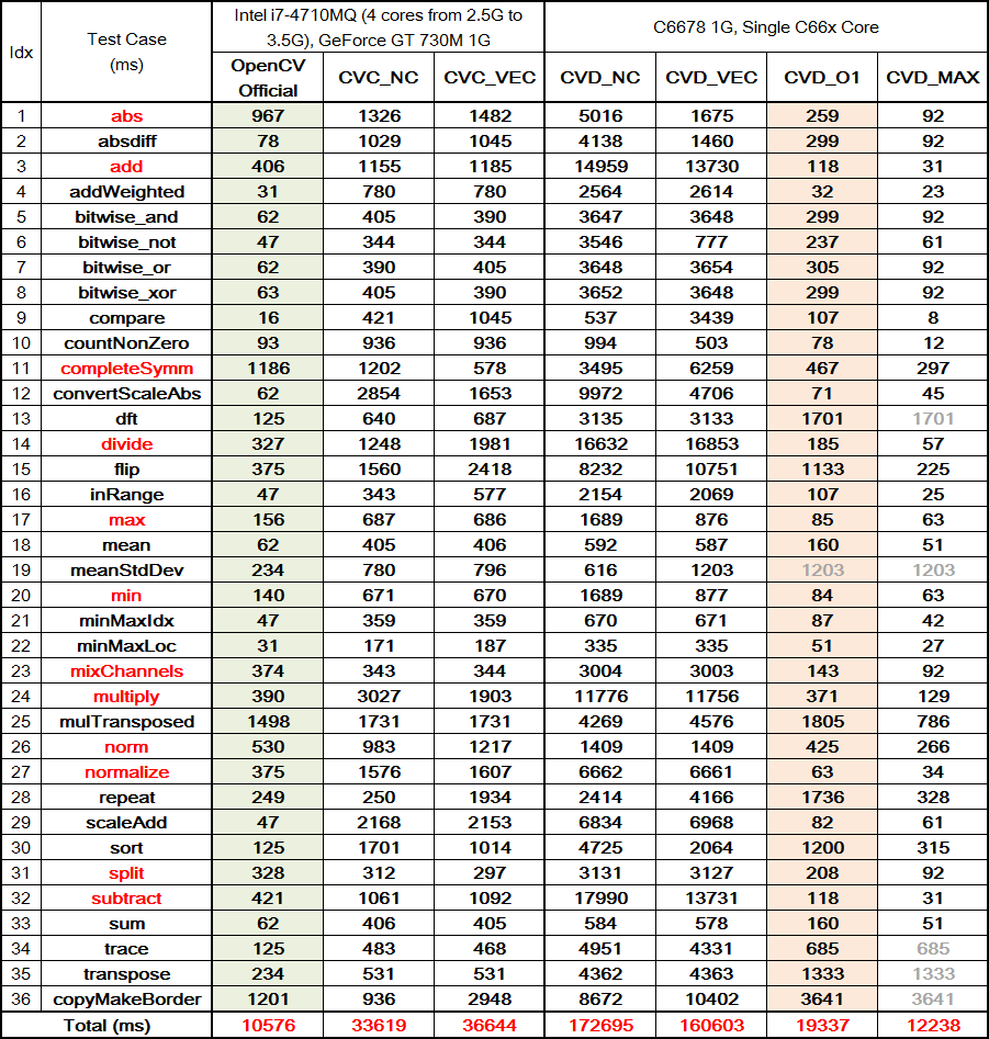

  • Hi Jeff,
    We are optimizing OpenCV3 on C66x too, so maybe we could talk about it. The following is the performance of the core module:
    The red ones are C66x faster than i7. The CVD_O1 means just by inner loop level optimizing, typically by VLIW assembly.
    My email address is: rex@cvdsp.com.
    -Rex Chou
  • Hi Anish,
    The reason that the C6x compiler is able to use SPTRUNC in the proposed replacement code is because the replacement code does two type conversions.
    First "int itmp = (int)*srcf++;" performs a signed 32-bit float to signed 32-bit int conversion which is exactly what SPTRUNC is for.
    The statement "*dstu++ = itmp;" performs a second conversion from signed 32-bit int to unsigned 8-bit int.
    This is not equivalent to the original statement "*dstu++ = *srcf++;" which performs a conversion from signed 32-bit float into unsigned 32-bit int before truncating the result to an unsigned 8-bit int.
    If the range of the incoming floats is [0..255], then you rewrite the original code to "*dstu++ = (uint8_t)(int)*srcf++;" to get the SPTRUNC loop. If the range of the incoming floats is [0..127], you could use int8_t instead of uint8_t for the type of the destination array. Then your original statement would generate the SPTRUNC loop.
    The reason the C6x compiler uses a call to the RTS function __c6xabi_fixfu in your original code is because the incoming float is signed and the compiler must assume that it could be negative. The __c6xabi_fixfu RTS function will convert negative float values to 0xffffffff. The SPTRUNC instruction performs a float to signed int conversion.
    Hope this helps to clarify the compiler behavior a little bit.
