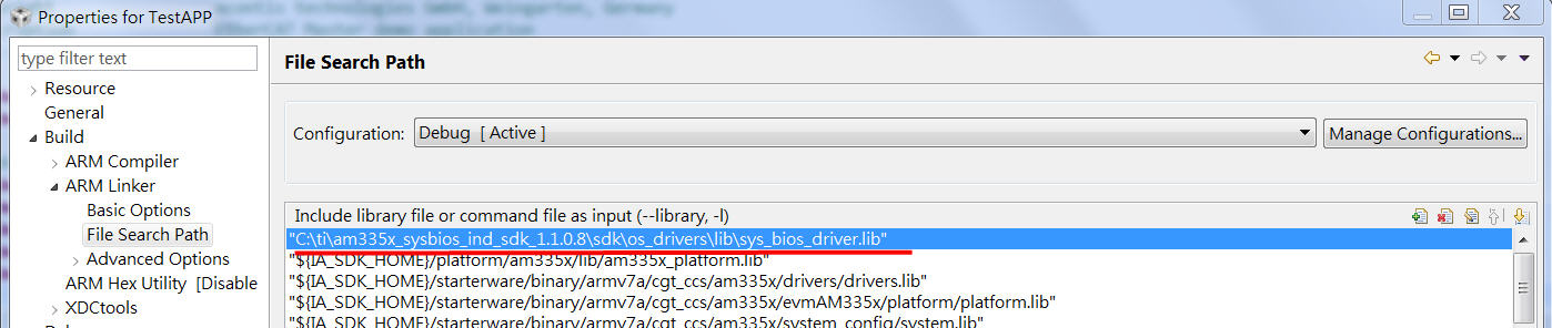

I am using CCS6.1.1 on win7 32bit. When I import third party's project and try to build it got linker error. I am unable to resolve this issue. Need help and advice.
My system configuration is as following:
am335x_sysbios_ind_sdk_1.1.0.8
bios_6_35_04_50
sysbios_ind_sdk_2.1.0.1
xdctools_3_25_03_72
Error message
undefined                                                                    first referenced
symbol                                                                         in file
ti_sysbios_family_arm_a8_intcps_Hwi_create   C:\ti\am335x_sysbios_ind_sdk_1.1.0.8\sdk\os_drivers\lib\sys_bios_driver.lib<osdrv_uart.obj>
ti_sysbios_family_arm_a8_intcps_Hwi_delete   C:\ti\am335x_sysbios_ind_sdk_1.1.0.8\sdk\os_drivers\lib\sys_bios_driver.lib<osdrv_uart.obj>
error #10234-D: unresolved symbols remain
error #10010: errors encountered during linking; "TestAPP.out" not built
I already had sys_bios_driver.lib in my project.

    The error is saying that sys_bios_driver.lib is referencing other symbols of where there is no definition. What you need to resolve is:
    Looks like it is related to some SYS/BIOS configuration. I would recommend checking with the third party to see if there are any steps you missed in importing the project.
