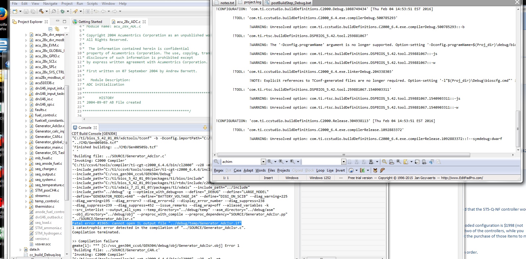

  • Hi Ki,
    I installed CCS v6.1 and the legacy project import went much better, but there are still a few problems.
    There are a lot of *.IF files that it has trouble getting, I'm not should what these are.  Also the old compiler flags -b, -js, and -w were not translated into something equivalent.
    Below is a screen shot.
    Any suggestions would be great!
    Dan

  • Hi Ki,
    You asked which DSP/BIOS version I was using with v3.3, but I was not using 3.3.  When I joined the company I was given a Windows 7 PC and they told me that CCS3.3 will not run on WIndows 7, so I installed CCS5.5 and started a new project from scratch.  Now I need to work on an old project that the persons who developed it are no longer with the company.
    I prefer not to go back to the old 3.3 compiler if possible.  This should be fixable.
    It seems that there is really just one compiler error with the *.IF files(which is repeated many times)
    Is the "IF" short for "intermediate file"?  If so can you tell me what step or tool would build this file?
    Maybe the intermediate file is not built or in the correct directory.  It might be a simple fix.  If I could get the entire compile/build process to stop when it has this error, it might be helpful.  It might be a path problem or environment variable.
    Once this is solved then I can go forward.  The warnings are less important.
    I just searched and saw that other people who had the infamous "Fatal Error #1965:" had a lot of trouble trying to fix it(that's scary!)
    I am looking thru the makefile to try to follow the flow.
    Here is another more readable screenshot...
