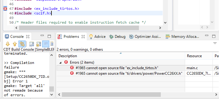

  • I've included (in theory) the rightful Links for all files or the projects I'm trying to merge and still CCS says can't open the source. :'(  ... I'm really getting so discouraged.
    I've also included this lines on the .project file under the source tree in the project folder.
    <link>
    			<name>scif.c</name>
    			<type>1</type>
    			<location>C:/Users/xXANGELXx/Documents/Texas Instruments/Sensor Controller Studio/examples/analog_light_sensor/source/scif.c</location>
    		</link>
    		<link>
    			<name>scif_framework.c</name>
    			<type>1</type>
    			<location>C:/Users/xXANGELXx/Documents/Texas Instruments/Sensor Controller Studio/examples/analog_light_sensor/source/scif_framework.c</location>
    		</link>
    and still is finding the same errors.
    Thanks for your help
  • The issue is that it is unable to find the header files listed (ex_include_tirtos.h and ti/drivers/power/PowerCC26XX.h). Check your include search paths and make sure the the paths to those files exist. For example, for the latter I think it comes with TI-RTOS CC13xx/CC26xx. In my installation, it is in C:\ti\tirtos_cc13xx_cc26xx_2_16_01_12_eng\products\tidrivers_cc13xx_cc26xx_2_16_01_12_eng\packages. Make sure a similar include search path exists in your environment. As for the other file, I'm not sure where that is from. But you need to specify the include search path for that file also in the project properties.
