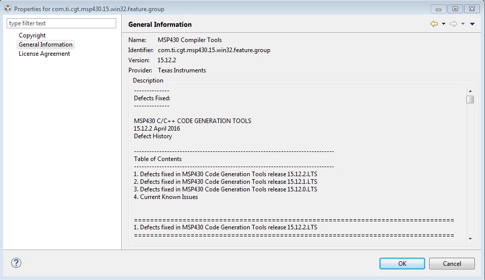

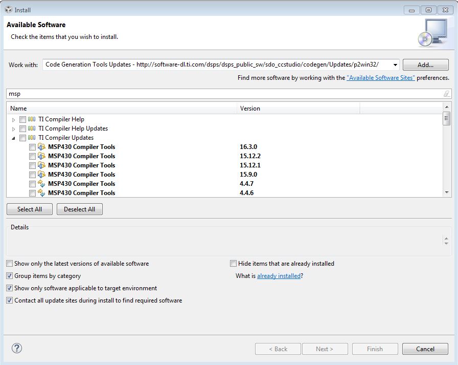

    It is also possible to see this information prior to installation.  It is easy to do, but a bit difficult to describe in a forum post.  In CCS, choose the menu option Help | Install New Software.  Set the Work with box to "Code Generation Tools Update - .../p2win32/" if you are on a Windows platform.  For those on a Linux platform, it is similar, but ends with "/p2linux/" .  In the type filter text box enter msp .  Expand the tree for TI Compiler Updates.  A screen shot is shown next.  Note which boxes are checked or not.  Match those settings.
    Click on the version number of the compiler you are interested in.  This populates the Details part of the window.  It is hard to scroll through that information in so little space, so click the More... link.  In the window that pops up, click on General Information.  Then you will see something similar to this screen shot.
