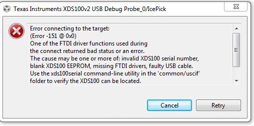

Few months ago, I made some projects in CCS for the RM48HDK. Today I re-open the same project and when I try to debug the code using CCS, it seems that CCS is not able to connecto to the onboard XDS100V2.. I receive error -151 (see below).

However, when I run xds100serial.exe from INSTALLDIR\ccsv6\ccs_base\common\uscif, the program returns:
No XDS100 emulators were found on the system
If I use the board on another computer, it works fine. We are able to download and debug the code in the target RM48HDK.
Any idea what could be the issue ?
