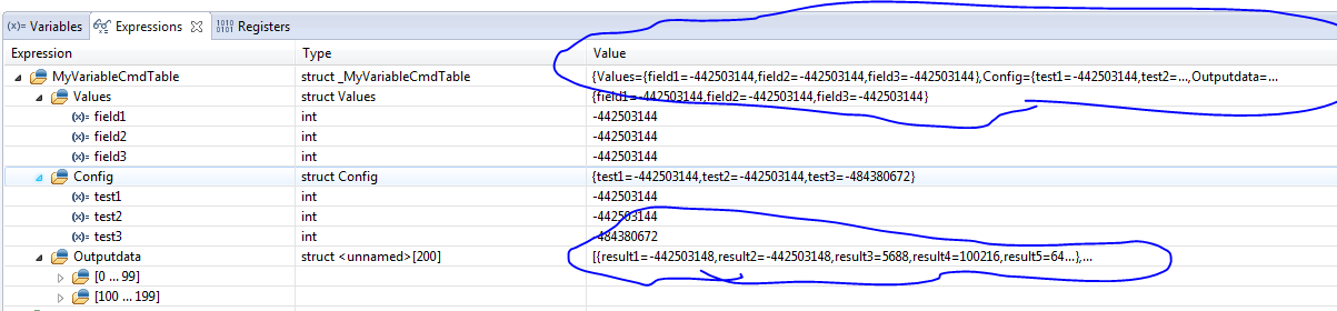

I am wondering if there is any way to overcome the following limitation in Debug View:
  • Expression window supports a short preview of data structures as reflected on the screenshot below
  • The output is limited to some amount of characters after which the only way to see the rest is to expand the tree, which is quite painful when data structures are HUGE and doesn't let us search data
  • I would like to see the WHOLE structure with all 200 array elements with no limits and FULL representation of internal data fields
If I am correct, this limited feature has been introduced around CCS v6.1.   However, it doesn't fully satisfy all needs.

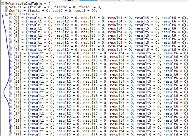

Popular (and unfortunately expensive) debugger studios like Lauterbauch Trace32 do represent table data in a MUCH and MUCH better way.   Every entry in OutputData expands as a table, and structure fields are represented as a single line.   Trace32 software is extremely old, but yet gives this convenience in representing table data in the best way possible.  So why limit the output?
Trace32 Example: endless string with Outputdata array with no limits
Trace32 Example: expanding array of structures
This also improves a search capability when I need to find fields with specific values.  How do I do that with CCS?

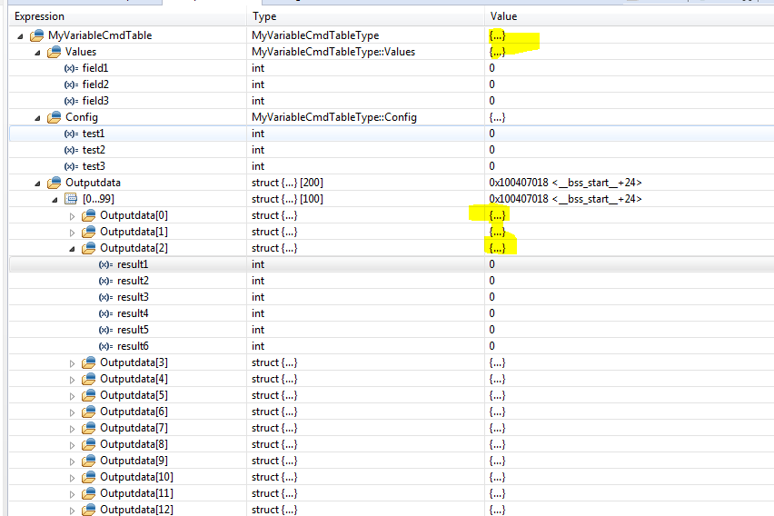

    We tried to trace it down with Eclipse source code and couldn't come up with any solution to remove that limit.  BTW,  Standard Eclipse CDT of the same version didn't have this feature at all (tried to create CDT project ).  Please point to the plugin we could modify if you think otherwise.  Since I assume it is a modified version of the original plug-in, not published to Eclipse mainline, I believe I can't adjust it for my personal needs as I don't know CCS API.  CCS Debugger core API isn't open source, right?  I can't implement table search/dump with the help of CCS scripting automation either.  If there was a search/filter that could output data based on the user query, it would be even better I think.  Having custom output scripts supported like in Eclipse for Java would also be very cool.
    Example of CDT C++ project based on CCS v7.1 to demonstrate no Value expression printed:
    >> I suspect this may be due to the impracticality of having the entire array displayed when constraints such as the viewport/workbench sizes are much more limiting.
    Do you mean that Expressions viewport in Eclipse has width constraints? It should be possible to connect Value column length to the quick format of each structure in Expressions view. If Value column length is smaller as by the default, then do limit correspondingly. If the user resizes that column and wants to see more of the one line formatted data in the structure, CCS should adjust that output correspondingly. I tried resizing Value column in Expressions and couldn't hit the limit.  I guess there are no size constraints in Eclipse (it should be RAM based).  A scrollbar appears at the bottom when column width goes above window size.  It seems like you can fit anything into that window, just like Trace32 does (there are no obvious limits).  At some point, it makes sense to apply some limits in Eclipse/CCS as there are users who don't have the required amount of RAM allocated for CCS/Eclipse process, or their debugger/JTAG frequency/remote connection is slow, hence it may take long time to output big tables whereas the user needs to look at the known individual items, which is why I think the feature should flexible/configurable based on some settings/options.

    There is a set development configuration options, which can be added to expression view(see below), that can be used to control the size and operation of the preview field. There is no search capability but as you mentioned this could probably be worked around by copying and pasting into a text editor. Since this is a public forum I need to put some warnings which may not impact your particular use case, but it might others. This is not an officially supported feature, having a very large preview will probably impact performance e.g. when single stepping or using continuous refresh mode as all that memory needs to be read in. Also, if there is a circular linked list type of a field in a structure and preview is set to a very large number, then preview will keep dereferencing pointers until that preview limit is hit. Pointer dereferencing can be controlled by setting 'cfg'::preview_dereference_pointer to 0.
       preview_length controls the length of the whole preview string
       preview_udt_length controls the number of fields in a struct/class/union to be displayed.
      preview_dereference_pointer controls whether pointer fields should be dereferenced.
     Please note that you need to specify the namespace 'cfg'.
