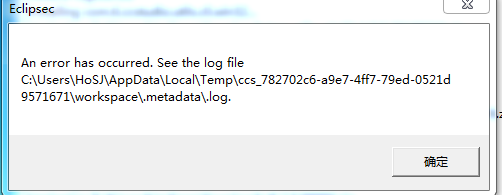

When setup CCS V6.2 of offline packet on win7 64bit OS, I met an error:
The conten of  file ”log“  is as follows:

And I tried to setup diffent version of CCS, such CCS V6.1, CCS V7.0 on the same commputer, the similar error occured when setting up.
Is there something wrong with OS?
and how can I  resove the matter?
thanks in advance!
    It looks like you're missing a windows update. Please go to processors.wiki.ti.com/.../Troubleshooting_CCSv7 and take a look at "Missing MSVC redistributable libraries". If this doesn't solve your issue, please zip up the contents of the install_logs folder and post here. Please make sure you're installing in a new folder or delete the contents of ccsv6 folder before trying.

  • Thank you very much!
    I uninstall all MSVC Redistributables, and reinstall CCS, now it is been installed successfully.
