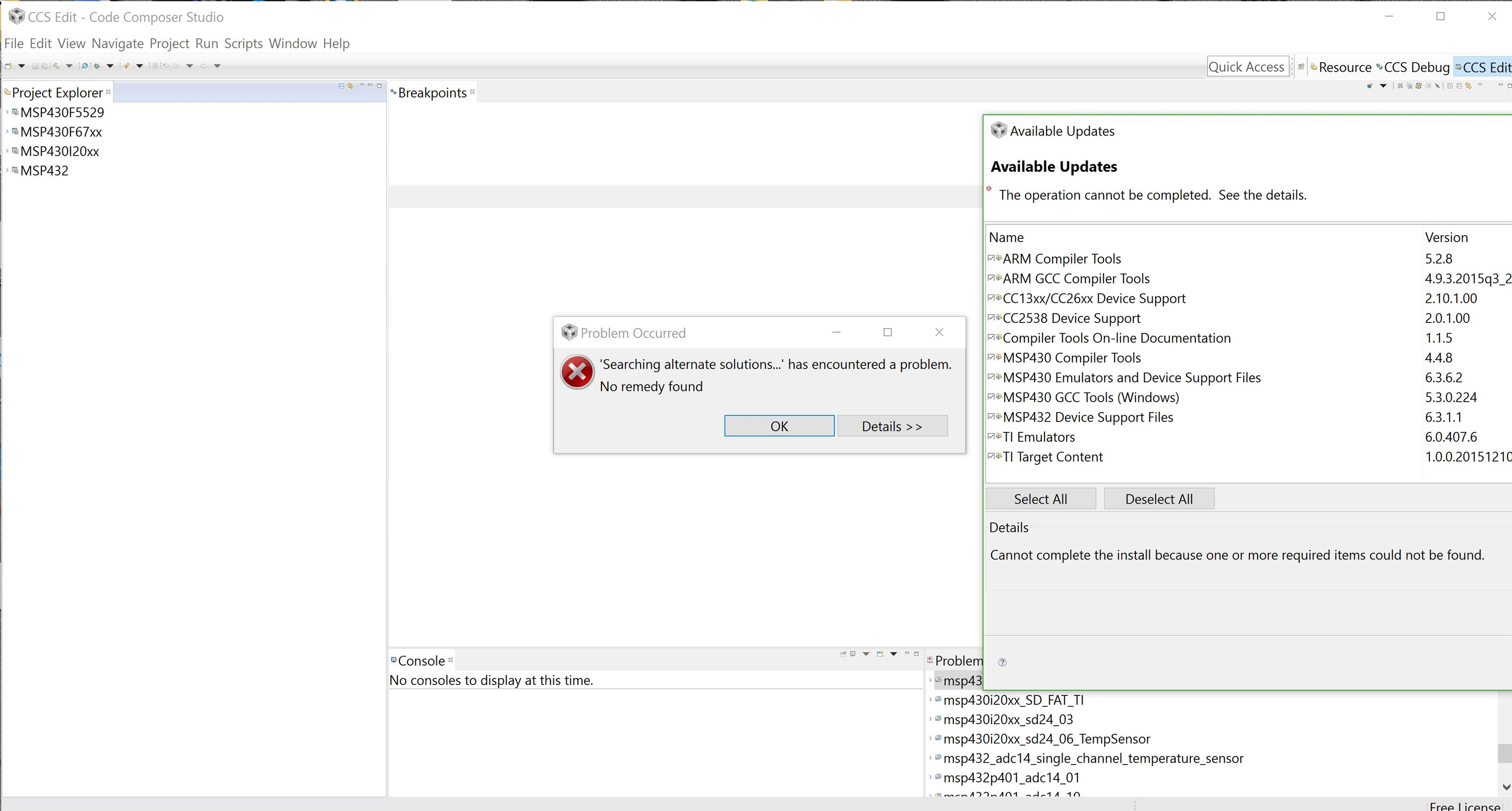

I am a novice at ccs, so I may not have the correct language to fully describe the problem. The first symptoms occurred during project import, then again during new project create. The projects did not show up in the Project explorer view. When i used right mouse button project properties the checkmark box for working set contents gives the error
!ENTRY org.eclipse.jface 4 2 2017-01-23 10:14:37.375
!MESSAGE Problems occurred when invoking code from plug-in: "org.eclipse.jface".
!STACK 0
java.lang.NullPointerException
searching the web reveals this error code has a variety of causes and partial solutions. I tried the command line - clean option which did not solve anything.
I attempted the CCS Help check for updates and hit an insurmountable problem, see screenshot below.
I will also attempt to attach the .log file in this post

!ENTRY com.ti.common.core 4 0 2017-01-23 10:11:22.303
!MESSAGE path=ccs_base/DebugServer
!MESSAGE debugServerDir=C:/ti/ccsv6/ccs_base/DebugServer
!ENTRY org.eclipse.equinox.p2.operations 4 0 2017-01-23 10:12:14.785
!MESSAGE No remedy found
!ENTRY org.eclipse.equinox.p2.operations 4 10053 2017-01-23 10:12:14.869
!MESSAGE Operation details
!SUBENTRY 1 org.eclipse.equinox.p2.director 4 10053 2017-01-23 10:12:14.869
!MESSAGE Cannot complete the install because one or more required items could not be found.
!SUBENTRY 2 org.eclipse.equinox.p2.director 4 0 2017-01-23 10:12:14.869
!MESSAGE Software being installed: CC2538 Device Support 2.0.1.00 (com.ti.ccstudio.cc2538.devicesupport.win32.feature.group 2.0.1.00)

John,
Which version of CCS are you working with? There were some known issues with earlier versions ( per this post).
I would suggest installing the latest CCSv7 that you can download from here: http://processors.wiki.ti.com/index.php/Download_CCS
Let us know if you still have trouble after installing CCSv7.

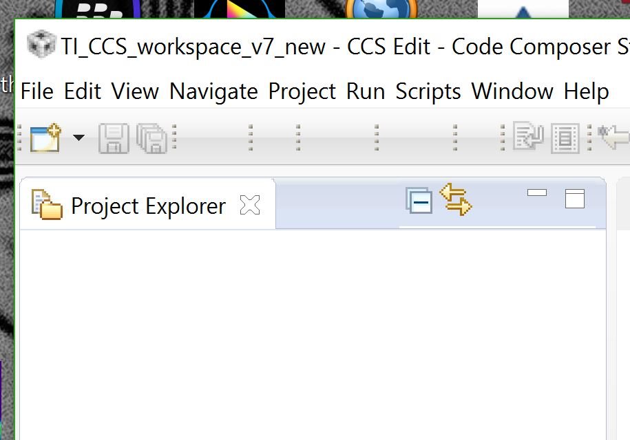

I was using CCS v6.1, I have downloaded and installed CCS V7 and encountered the same problems (only worse)
when I add projects they do not appear in project explorer. My previous work around would be to use the file explorer menu to manually add the project to a work group. (which also gave a string of errors in V6). Now in V7, the inverted triangle which should give me access to edit active working set
the following not available to me "Click the black upside-down triangle icon to open a menu of items specific to the Project Explorer. Right-click inside the view to open a context menu. Opens the Edit Working Set dialog to allow changing the current working set."
see image below
Jack
Jack,
Your images are not coming through for some reason.
john bouska said:when I add projects they do not appear in project explorer.
Do you mean when you import them they don't show up in the workspace? Are you using a new workspace with CCSv7? It is recommended to use a new workspace with each new version of CCS (esp major version changes) and you can then import your existing projects into the new workspace.
When I installed v7 i pointed to the existing workspace, and CCS updated the old V6 workspace to V7 standards (warning that the changes would not be backward compatible.) all existing projects were accessible however new projects are only visible in navigator view.
The old way in v6 was to use the project explorer view menu to select working sets and either add the new project to an existing or new working set. without the view menu in v7 i'm stuck.
see attached image, notice the yellow circles and red arrow.
The view menu button (down pointing triangle) is missing in my ccs v7 installation. It turns out this is a mission critical option, without it i cannot use V7 to initiate any new projects.
How do I fix this, or is there a menu work around?
john bouska said:The view menu button (down pointing triangle) is missing in my ccs v7 installation.
That is odd. I see it fine in my CCSv7 installation.
john bouska said:When I installed v7 i pointed to the existing workspace, and CCS updated the old V6 workspace to V7 standards
A couple of things to try (let us know if any of these help):
- reset perspective by going to menu Window->Perspective->Reset Perspective
- open a new workspace in CCSv7 and check if the "View Menu" icon is present
Thanks for the reply, I just tried both suggestions and neither worked to restore the view menu button.
does CCS have any other way to access the view menu?
thanks Jack
It sounds like something may be corrupt in your installation and unfortunately I'm not aware of a direct, quick and reliable way of fixing this.
Sorry about the inconvenience, but at this point, I would suggest a complete uninstall and reinstall of CCS. Before a reinstall make sure to completely delete the directory where it was previously installed so there are no left-over components.
I uninstalled the original v7, deleted the install directory, downloaded a completely new install zip for offline install, confirmed the md5 checksum was correct, installed ccsv7 from the new download and I continue to have the problem of the missing menu button on project explorer.
any suggestions?
john bouska said:installed ccsv7 from the new download and I continue to have the problem of the missing menu button on project explorer.
Could you please attach the workspace log file for this workspace that you open with CCSv7? You can find the file (it is named .log) in the .metadata directory inside your workspace.
log file below:

thanks Jack
Some additional information:
the missing edit symbol in projects view problem with CCS v7 occurs only on my high spec Dell M3800 laptop (with 4K screen).
Yesterday, I tried installing the CCS V7 (CCS7.0.0.00043_win32.zip) on another lower spec dell Windows 10 computer with a lower resolution screen,
and I can confirm that the edit symbol is available on the lower spec dell (with lower screen resolution).
I tried lowering the screen resolution of my 4K dell m3800 down to 2048x1024 and restarting CCS v7, however the edit symbol is still missing.
so the problem has to do with the install on my m3800, however i have not had any problems like this with previous installs of CCS (4,5 & 6).
thanks for the help so far.
Jack
Jack,
Thank you for replying back with this update. In fact I was just going to post a reply to you as the engineer who reviewed your workspace log file said that it looked ok, and that the issue was likely due to something specific in your environment. It's good to know that you were able to isolate it to the 4K resolution screen. I will file a bug report for this issue so we can look into it and address it for a future CCS release. Until then, if that menu item is critical to you, please use a machine with a lower resolution. Sorry about the inconvenience caused due to this.
Jack,
I filed CCSIDE-3066 to track this display issue in high resolution screens. You can track it using the SDOWP link in my signature (after giving some time to allow it to sync).
john bouska said:do you know when the schedule for the next V7 release (update).
The 7.1.0 release is scheduled for end of Feb/early March. However since it is already so close to release it is likely that this issue may get pushed out until the release after 7.1.0, unless there is already a fix available.
